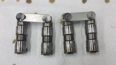

How common is it to have one go bad? I have about 2500 miles on a zero decked 493 rb 12.5 to 1 street car; Brad penn oil with 3 oil changes.
Took the road runner out yesterday. I got on it probably 5 different times. Taking it 6000 rpm. I my last WOT, I stabbed it, tires broke loose and it hit 6500. Looks like my rev limiter did not kick in but I shifted at 6500 at the track last year for about 10 runs. Well when I come to a stop I hear a hard tick and my rpm, usually 1100 now sits at 1400 at idle. Strange in rpm.
I look at my oil pressure and it's solid at 38 at idle and hot. I coasted it home and figured I'd pull the valve covers and look for a bent pushrod. When I pulled he covers I noticed the intake rocker on cylinder 4 was very sloppy( like 1/8" lash) I run 3/4 turn past zero normally. I pulled the Hughes rockers and pushrods and they all look great. So I figure I kissed a valve and it's hanging open, but an intake valve? I put a straight edge on the valve stems and they are all at the same height.
I tried pushing in the lifters this morning and they are still all solid but notice that the bad lifter has the pushrod sitting a little lower than the others on the base circle.
I know what it is but dammit I don't want to pull the crossram, and the heads just to change out a lifter. I don't think the valley cover with removable window will fit under a cross ram.
so any of you lose a lifter? I'm going to leak check the cylinders before I pull it apart also.
Tom
I lost two of them so far. Comp cams roller lifters. The plunger sticks in the lifter and then they wont pump up anymore. Common issue with comp rollers. Google it..
That's why I run am edm solid flat tappet. It's not uncommon with new roller lifters except maybe a set of johnsons
Have had good luck with Crane hyd. rollers.This set in second build running great in my 493. hope I didn't just jinks myself.
