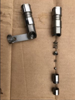

The culprit is a broken plunger spring.
The internal lifter spring isn't a "loaded" item. So valve spring pressure should not have affected it. Just poor luck. Why couldn't you remove the valley plate?

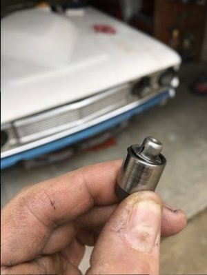

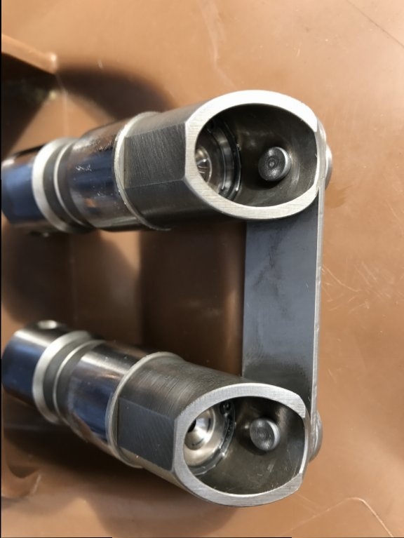

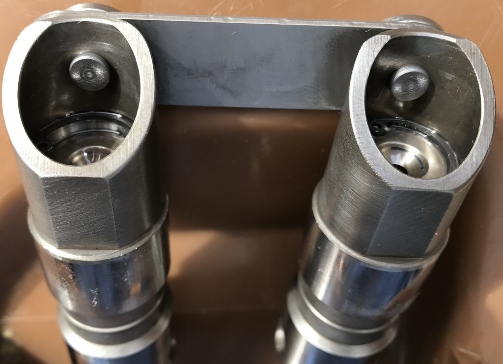

Anyways I opened up the bad lifter and you can see the bottom of the check valve retainer is partially separated from the plunger. I checked all my geometry before I took it apart with a dummy lifter and rocker height and push rod length are perfect.
