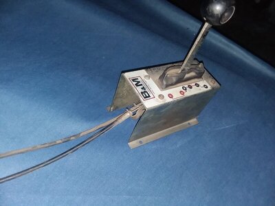

I think you need one of these.
Just kidding. Sorry, couldnt help myself.
Edit: (for those who might not know, its a fifty year old chrome box, specifically for pushbutton trans. Note, two shift cables, one for park)

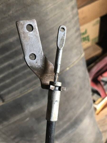

I’ve got a ‘64 pushbutton shift cable in the garage. Don’t need it because I have the console. I’ll dig it out and take photo or two. ...............

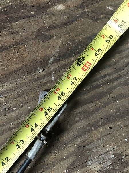

They are pretty close. Easiest way to tell the diff is the gap behind the bullet nose that goes into the tranny. Small gap is pushbutton, big gap is console and ‘65.
Here you go. 46” cable, standard for ‘64 big block, a couple inches longer than the small block...........
