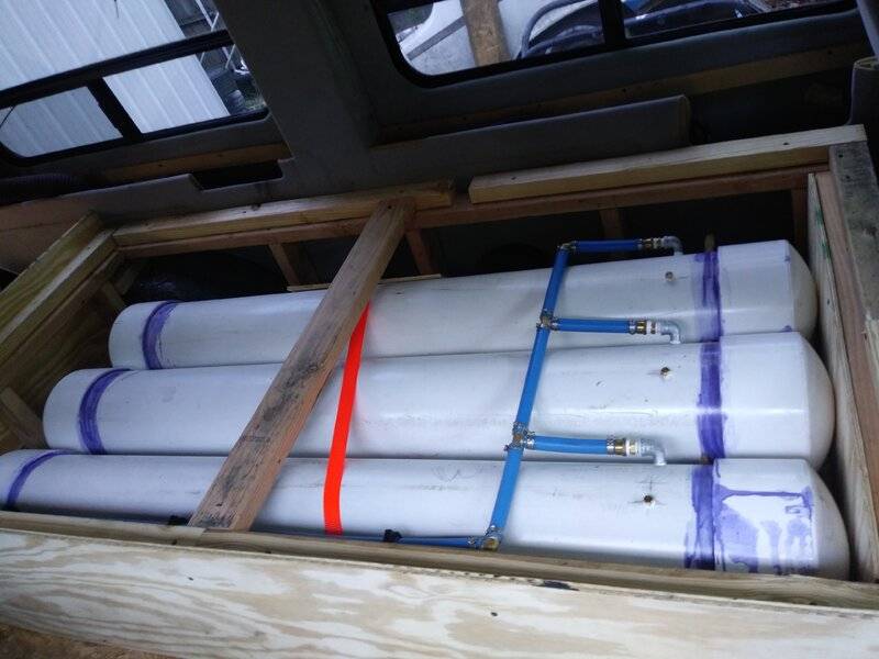

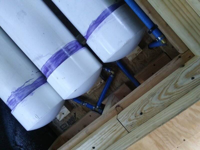

here's the water tank, I didn't want it to slosh around so I made it out of three 8 inch pvc tubes....... it fills/drains through a hose bib on the bumper and is vented

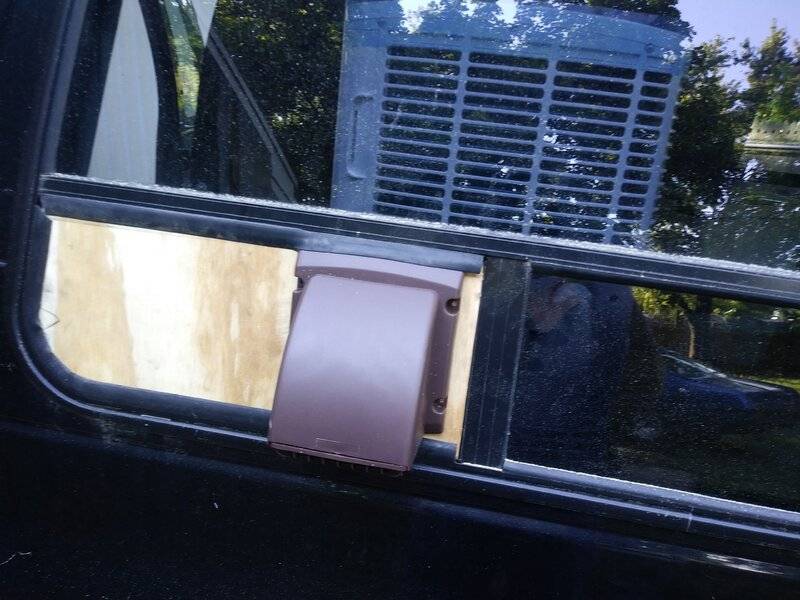

and nothing says mobile meth lab like a dryer vent hanging out the side :lol:
Breaking Bad springs to mind...... :lol:
My old motocross bus we filled 8” pvc pipe with air pressure to inflate tires and to pressurize the 3 8” pvc water tanks on the roof. They were painted black to use sun to heat the water.
DAMN GOOD JOB!!! Too much thought & engineering into THAT to be even considered as "PINEY ENGINEERED"!! Great utilization of space!!

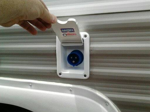

An inbuilt surface outlet/inlet on the Motorhome bodywork would be useful .....making sure to get the genders correct - Male socket on the exterior of the vehicle, so that the Female end of an extension cord can plug in, and be safe of course. :D
thanks kiwi. valuable info..... I know enough to be dangerous....... the male socket thingy is something I was wondering about

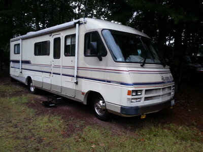

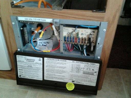

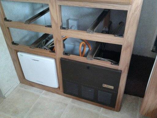

The American caravan/trailer I worked on a few years ago needed a complete rewire - the USA cable is not legal here, and I had to re-work the mains/12-24VDC system to separate them out a bit better.

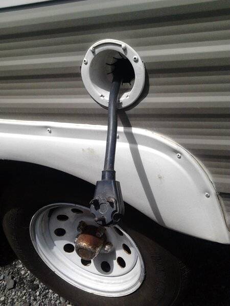

I changed the dangling lead to a fixed socket for the mains in also...
White doors conceal the mains side of the power - circuit breakers etc - kept the 12 volts DC for the lighting....and the side-shift that opens the dining area up.
