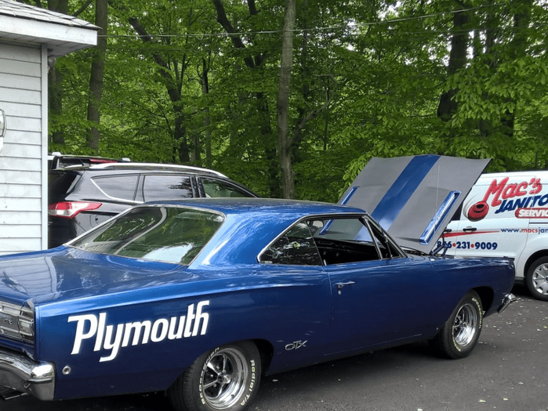

Yes, I have heard that the aftermarket hoods are not great. there is no damage underneath except for the bends on the sides so I am hoping they can fix it. If not I have a lead on a used one.

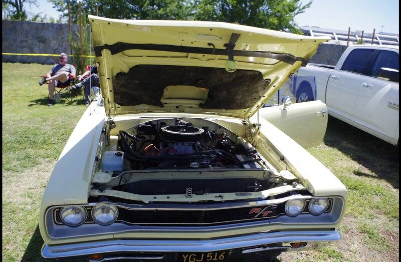

Secondary latch with a tennis ball on it when the hood is open. Lol. Don’t ask me how I know.
Waiting for Dennis H to post a photo of his Yellow Coronet with the hood open, tennis ball in place and a zoomed-in photo so we can read what he's written on the underside of the hood in permanent ink!
Latch sure looks long at least longer than mine...well keeping it to the latch..

Thanks, the paint is B-5 blue so they should be able to match it. I'm hoping they can fix it because it does not have a crease in the middle, its just the sides.

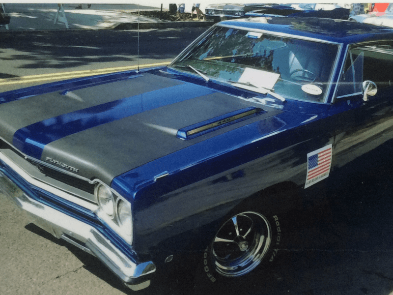

@mpro69rr This happened to my GTX too. I had the secondary latch, but it didn’t catch at 35 MPH. The underside of the hood ripped but the upper side only bent. $100 repair at my local experienced body shop guy. He straightened the top, welded the underside and touch up painted the underside’s welds (black, so it was easy for him to match with some paint he had left over). The paint on the top side never cracked.
Good luck! My problem was that the primary latch let loose sometimes. I fixed that so this will never happen to me again.

Good luck! My problem was that the primary latch let loose sometimes. I fixed that so this will never happen to me again.View attachment 1289320 View attachment 1289323
Nice Ride! Yeah that's pretty much what happened to mine, I was going about 35mph. I only have two dents ,one on each side so I'm hoping it can be fixed. The paint on the top didn't crack or bend, which is good. I'm hoping he has to just do the black then I don't have to worry about him matching the blue.
