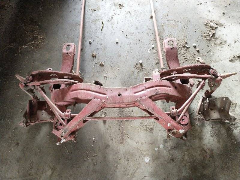

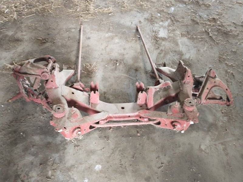

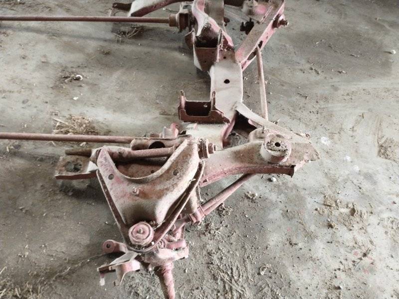

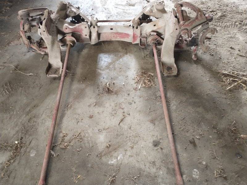

Can someone tell me if this is a Big block " B " body K-member. Working on a 1973 & 1974 Plymouths;
Thats a nice part. Hard to find one with sway bar tabs.
The difference is on the motor mounts.
Big and small fit the same K.
With all due respect. That K'-member is bent & twisted as well as broken in a couple places. Had I see that before bought it, I wouldn't bought it. As far as the sway bar tabs, I'll cut them out and weld them on 1 that's not bent and twisted. Thank you for help.

I don't think you're right on that. From what I read, after 1972, there were different K members for each engine family. The main differences were the shape and placements of the motor mount pedestals.

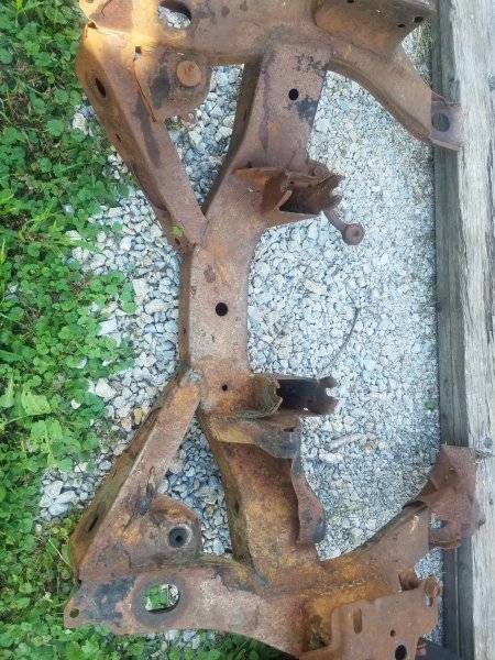

I have this one out of a 73 318 Charger that I took out and had sand blasted to swap into another 73 charger that was a slant 6 car
Car got sold before I got around to doing the swap
Too bad you are so far away
I can measure anything you want to compare on yours

Gawd I wished you were wrong, but I really think you're right. I got 1 out of a 73' now and they almost identical. Aside for the sway bar mounts.
I believe all 73 and 74 B body cars except WL and RL got front sway bars.
Yes the mounts are different between big and small block.
75-78 BB K frame is a direct swap.

To answer the OP's question. Yes that is a big block K member. Big block, small block, and slant 6 are all different for 73 and up.
The biggest give away on big block vs small block is the passenger mount has a triangle bracket on the big block and an L shaped bracket on the small block.
