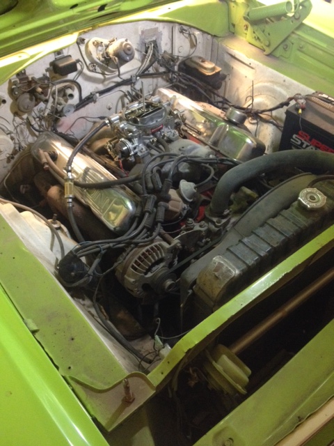

Apparently it IS a 69 383 2barrel setup from a Fury Police car...
A friend came over yesterday and asked me why this thing still has the stock manifolds yet the big upgraded intake. If they were shooting for performance why didn't they put headers on it? Now I figure Because they were just getting rid of the crappy 2 hole intake.

welcome, great to see another '68 Bee. I've read recently where the factory HP manifolds are as good as headers.
