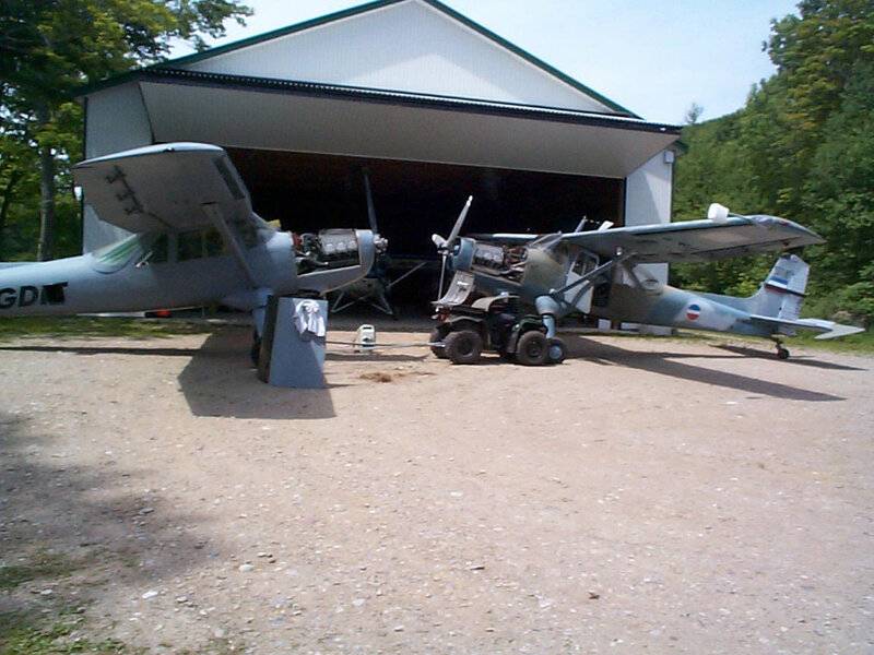

I have a hard time believing that a 3/8 line and a 120 GPH pump ( TWO GALLONS PER MINUTE) pump can't keep it breathing!..or I'd have gone down in the trees by now!
Tell me about your engine build please.
480 HP .. 52 US GPH fuel burn on take off.. through a 3/8"fuel line. You'll never run full throttle as long as I do,,,,
Now I understand the "down in the trees" comment, but I'm a little confused about this quote. Is your plane's fuel pump rated for 52GPH or is 52GPH the rate of consumption on takeoff at 480HP or???
It's burning, at minimum, 52 US gallons / hr of fuel, for over 5 minutes on take off. Can't see your car ever touching that need.

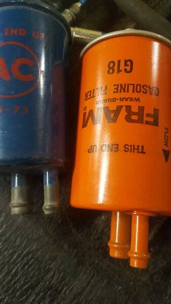

A sump in the tank is the best thing you can do. If you street drive in the heat a lot use the return, some years pontiacs use a 3/8 filter with the 1/4 return and the 1/16 restrictor is in there. Gf16 I think it was.
Way cool prop jobs dads bee! Love to go for a ride! I know I jumped off subject— sorry
You can make your own use a tee and solder up a fitting with a 1/16 hole, try to locate it at the top, pointing up, of the fuel system to get the air bubbles out. Factory one has a screen to help do that and to get the chunks out. I assume you have a filter somewhere, if not g18 may be your friend, filter must be on pressure side, only screens on suction side.
