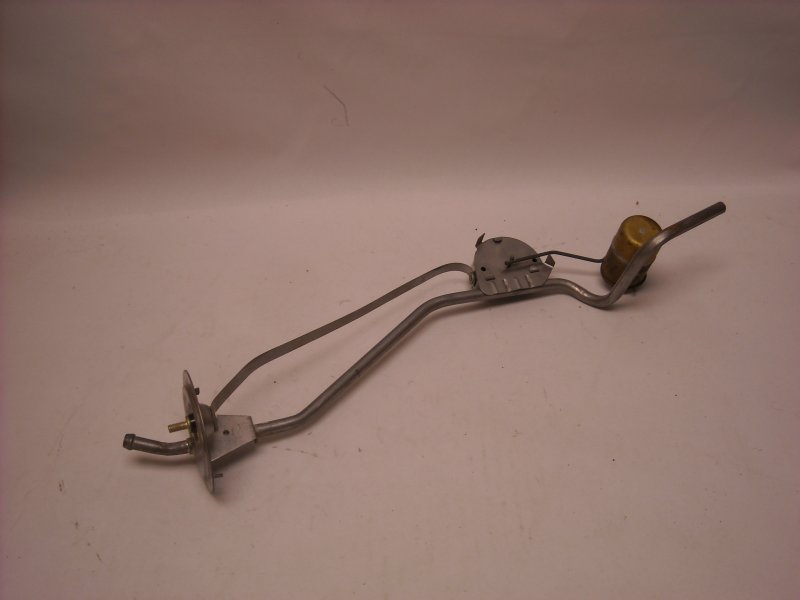

Anyway, YMMV but I'm really happy about this and I wanted to share! I've put a few pics of the one I got a few years ago that actually has the sock that is too long compared to the pic of the NOS unit. The OER seems closer to stock (except for the tangs on the side of the unit) is the correct length to the sock.
Here are pics of a NOS 5/16 sender with the tangs on the side, and a comparison of the 3/8 eBay and OER fuel senders. OER is on the top and the eBay one is on the bottom in the pics
