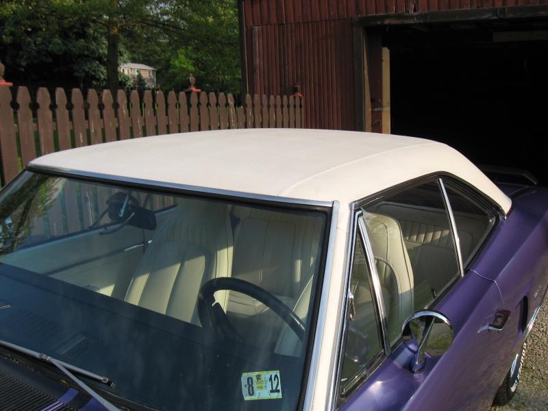

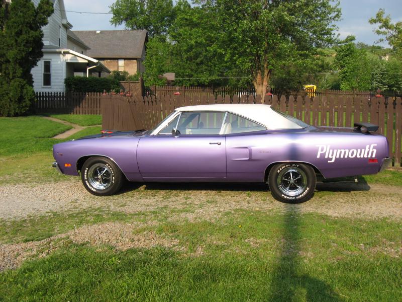

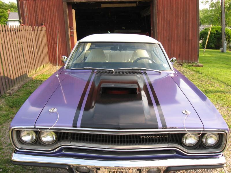

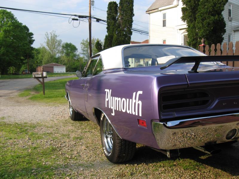

white vinly yop
here ya go PABSTER. i should have taken a pic of it halfway done, right down the middle.. then you could see how much dirtier it was compared to how clean it got.....but i was so damn EXCITED that it was coming clean that i didnt wanna go get the camera,,,,but here they are and WHAT A DIFFERENCE! it was kinda...dingie white...almost ...like DIRT . this will do until i get the car painted and a new top put on!
enjoy.... :hello2:

damn i love your 70, dog, im stealin' these pics for my archive!!!

Tpod, I never thought about that simple green, I use it hear and know how well it works so it sure isint hard to believe it would be great for that! Looks like a new top! Good thinking man.

Tpodwdog, not like I'm telling you something you don't know, but your car is INSANE. God damn, what a beautiful vehicle.

Don't worry about spending money on paint! Your car is lookin' great with the paint and top as-is. Looks good man.

She's looken' perty now...
