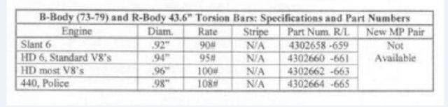

Here's the downside... you have a 74. Be very careful because the 73 and later bars are different lengths than the 72 and older ones, but a lot of dealers list bars as 71-74. Make sure you're getting 73+ bars.
yes, I have noticed that. Thanks for the confirmation. I see that P-S-T does not have them. I just miked mine and came up with 0.92 and that is after I blasted tham.
saw where FF would rebuild the old ones for $200 + shipping to and from. I'm thinking because I need to replace them might as well up grade to larger. But larger is more $$$.
Long shot but you could look for Cordoba/Fury/75 and up Charger bars at a U pull.
I see one of those about once a year on my 4-6 yard quarterly rounds.
