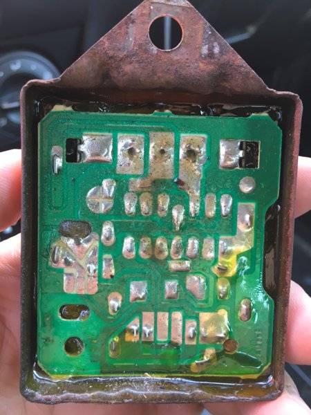

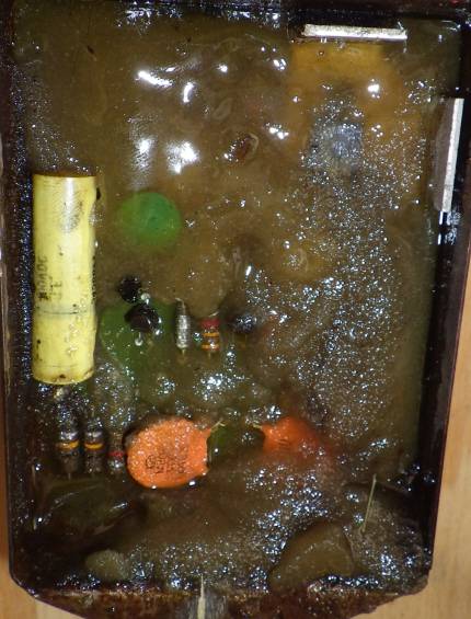

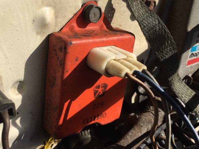

As I was swapping those parts out, I noticed that the gel in the EGR Time Delay Module (pictured) was running down the fire wall. I took it off and, yup, the gel melted out of it. It must hacve got so hot that it melted the gel! My question is, would this part prevent it from starting?
I don't know the answer to your question, but the potting material they used does get old and breaks down. It happens to ignition boxes as well, no heat required. Happened to an old one on my shelf. If you posted the vehicle you were working on it might help. :D

It's for my '79 300 with a 360. There is no lean burn system currently, someone before me removed it all and replaced the carb with an edlebrock
It shouldn't prevent it from starting the pickup in the distributor or the Ignition module are probably the culprits .

My EGR module leaked on mine and the car still runs fine.
Is the coil getting power to it? Might have to backtrack the ignition system. Do you have another ignition module you can swap out to try? Kinda the nice thing I have owning 4 of these cars always have “spare parts” to try out before I spend any money.

Sorry for not getting back to everyone, I know you were all sitting next to your computers waiting for me to let you know! Turns out it was the ignition module and a wire that I must have blew off with the pressure washer (insert head slap)
