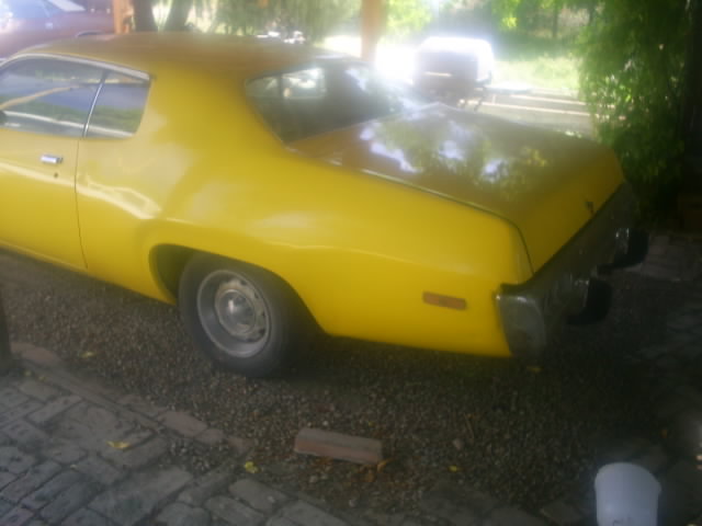

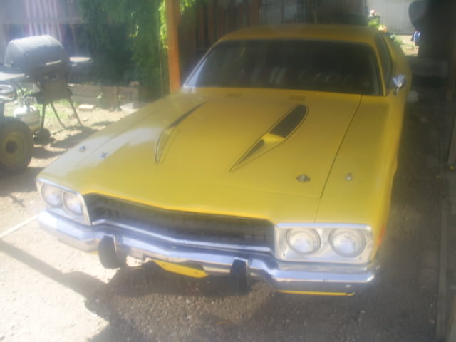

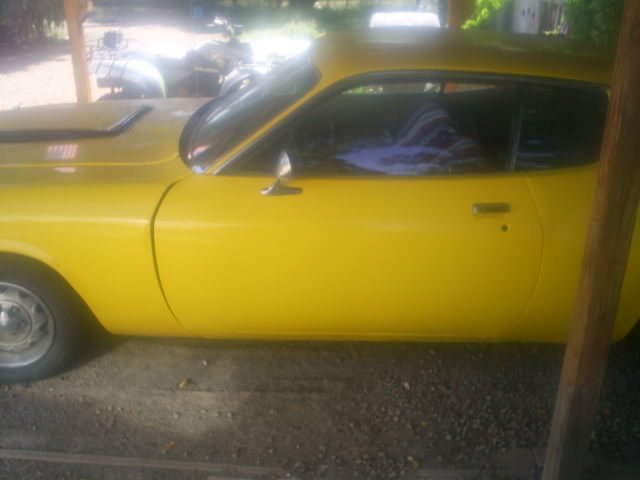

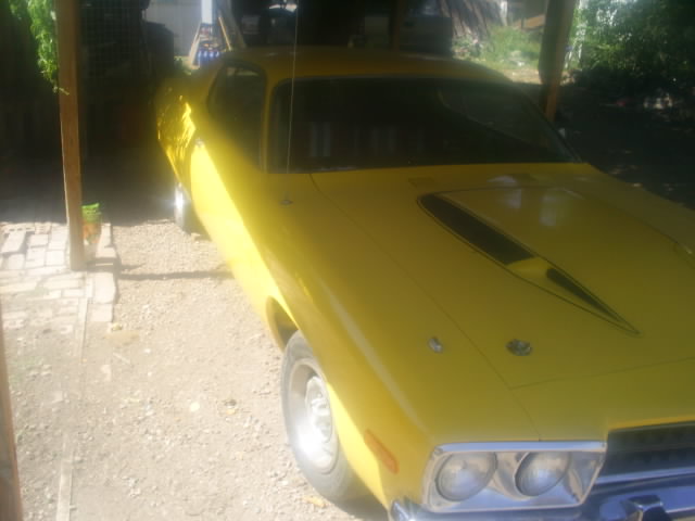

Guess what moved under its own power!!
I'm so stoked; it's driving for real this time!! Of course, it snowed here recently, so Manfred pulled it from under the carport and immediately got it stuck. :thumbsup:
He got it unstuck, though... so now, here it sits next to my other car until it's road-ready!

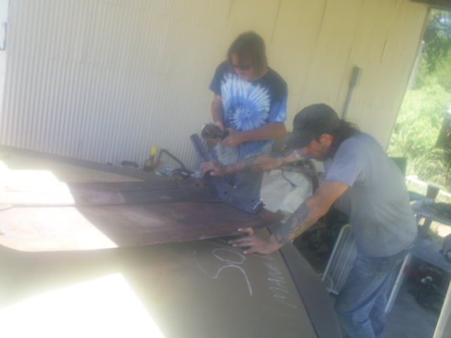

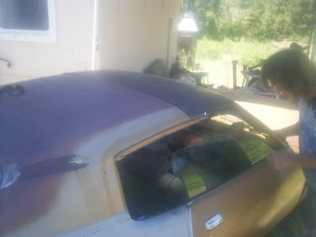

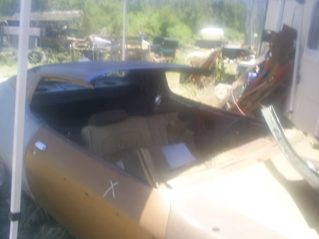

Ari has been super busy with work but we did do the roof splice to get a windshield in. A loader had brutally lifted the car sometime in the past at the yard. It distorted the roof so badly there was no way to really fix it w/o a splice. Luckily a parts car came our way so problem solved. Jason and Brian did the heavy lifting and welding on this one. Had a broken windshield on hand to test the repair and we are spot on! Next phase is some body work and putting the inside together.
You guys definitely win the Frankenstein award for a 74 Satty. It's been fun watching the progress.
Thanks, it just did not seem right to give up on a 64K rust free car that they will never build again. Fighting rust is very time consuming, so even though this was a massive undertaking, its actually easier than massaging in rusted areas. We will do body work next and prep the roof for vinyl. The whole car will get rattle can primer for now then the art work will get underway. We will have some pro's do the lay-out and work and then maybe a road trip to Houston for Artocade?? Still have to do the waterpump before any real driving. I did splurge on a Chinese 2 BBL, 30 years of sitting froze up parts of the Carter. I've ordered like 5 of these "foreign jobs" 3 worked OK 2 were a disaster. WE will see!

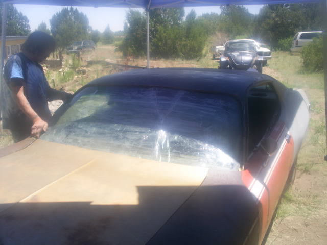

Come do my 72 400-4 barrel Charger roof!
We had to buy a whole donor car to find a usable roof section. There are no more in any junkyards near us. If the car was a vinyl roof car the "C" pillar is a lead seamed joint with plenty of "play" in fitment ( I've always imagined some Mopar line worker with a bazooka gun full of seam sealer after spot welding!). Our car was and will be again a vinyl Sebring version so that made this much easier. If the weather cools of this weekend we can more done
I thought it was the other way-
Vinyl roof= plastic filler
No vinyl= lead
Hmmm, I'm not an expert and what you are saying makes more sense, but this one for sure had lead and no filler of any kind. Maybe a "Friday" car that the lead pot people wanted to finish off a batch on hand. I'll get a close up shot of this. Thanks for the clarification
Interesting.
Maybe because it's a "halo" top.
Yup the corners of the "C" pillar are definitely leaded with a large gash in between that may have had body fill at some point. The dry Colorado weather and years in a yard probably degraded any of the fill, or there was none since it got a vinyl treatment. Got the inside back together ( ish) , windows meet the seal 100% ! Fighting a partially frozen stud on the waterpump. Its soaking and I'll give it the torch tomorrow. Then the car should be fully mobile and good for yard drives at least. Then its back to work and save for a windshield , this aint a Roadkill build with bottomless corporate sponsors ( really don't like most car build shows on TV , they distort the hobby and instill false hope into the "everymans" dreams..don't get me started).

Thanks! Waterpump in! Took a full 10 minutes on the seized stud with propane torch to pipe wrench it out, It was the one that holds the power steering pump adjuster and I did not want it snapped off in the timing chain housing. Today was first round of mud on the splice areas and its looking pretty good. Having parts cars on hand makes the hunt for "smalls" much easier. Got the interior panels on as well. Getting closer....
