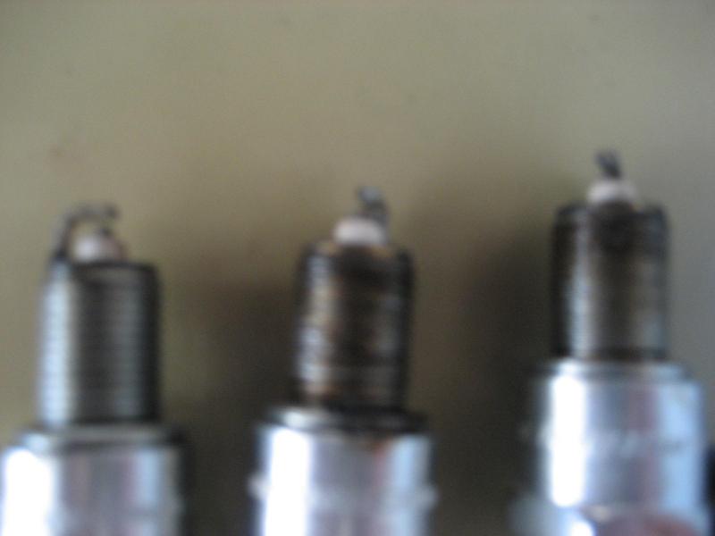

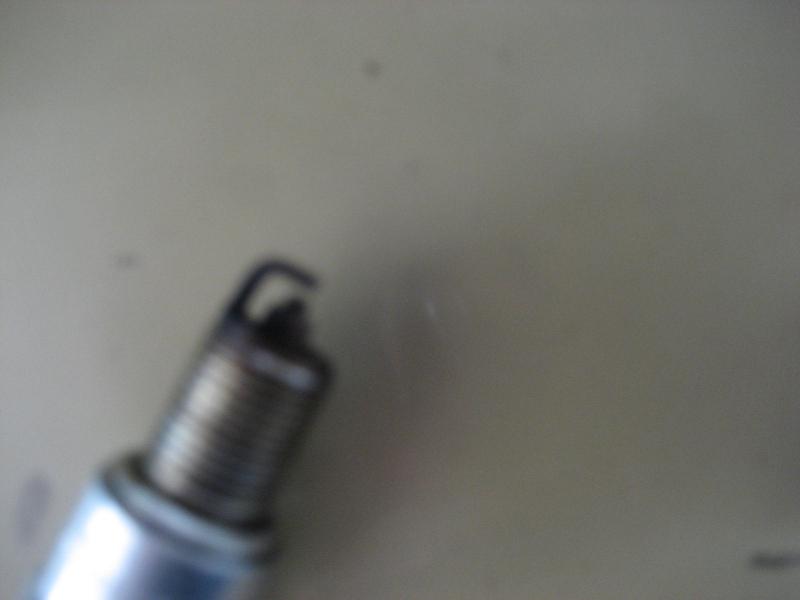

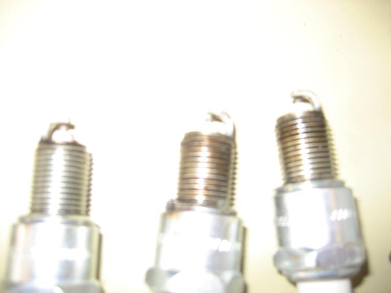

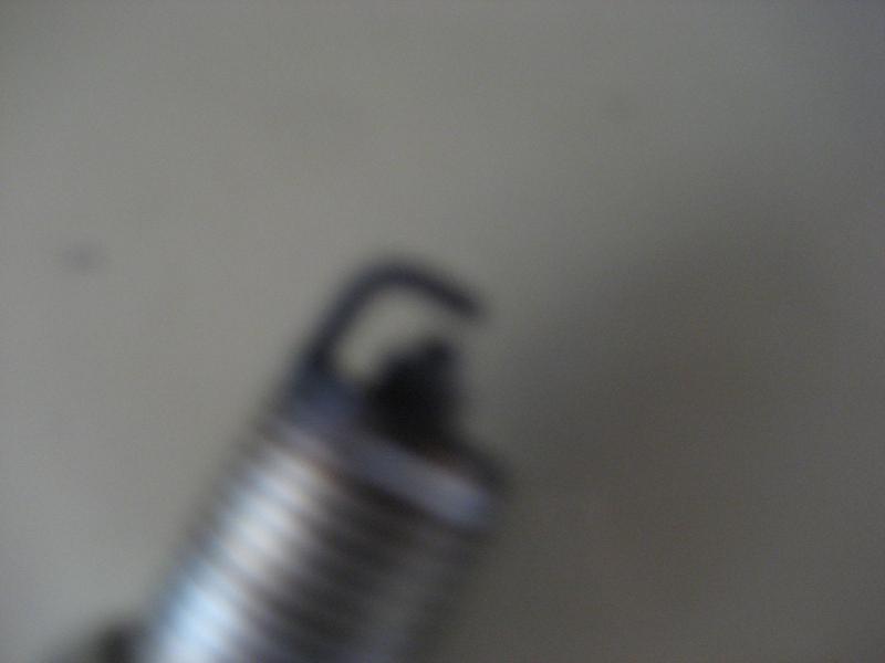

003.jpg004.jpg005.jpg008.jpg007.jpgThe three spark plugs are from right side. The single one is out of number 8 cylinder it's the worst one. Will do right side later.
