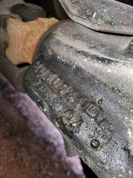

Hello again, I will be sending in some more pictures of the 68 charger. I was getting the gear ratio and I believe it to be 3.55 ( I marked the driveshaft and tire and spun it 10 times) but I had noticed this stamp on the differential. I'm not sure what that means. During this process I asked myself, would I need to switch the axles and differentials if I want switch the auto trans to the TKX 5 speed?

Look on the differential cover, there should be a tag under one of the bolts that will have the gear ratio on it.

Hello again, I will be sending in some more pictures of the 68 charger. I was getting the gear ratio and I believe it to be 3.55 ( I marked the driveshaft and tire and spun it 10 times) but I had noticed this stamp on the differential. I'm not sure what that means. During this process I asked myself, would I need to switch the axles and differentials if I want switch the auto trans to the TKX 5 speed?View attachment 1392598
The 2070741 carrier casting number tells you it’s an 8 3/4” rear axle with a 1 3/8” pinion made between 64-72. Used on low to medium horsepower cars. It is a strong rear axle, but the 742 casting is a bigger 1 3/4” pinion to handle more horses from the HP engines. Look for the tin tag where the chuck fastens to the axle housing that will tell you what the gear ratio is. It’s a little strip of metal stamped with 2.94, 3.23, 3.55 possibly.
I found my tag on the differential cover. I have the 72 8 1/4, is it different for 8 3/4 or other years?
Yes, there is a difference in appearance. The 8 1/4” has a removable cover on the rear of the housing and the gear ratio tag is hanging from the fastener of the cover. The 8 3/4” has the tag hanging from the carrier assembly fastener.
