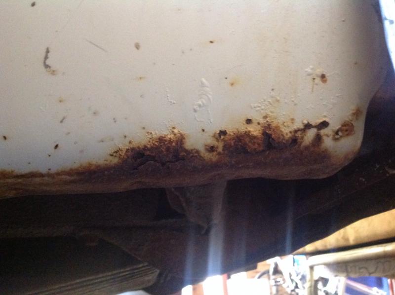

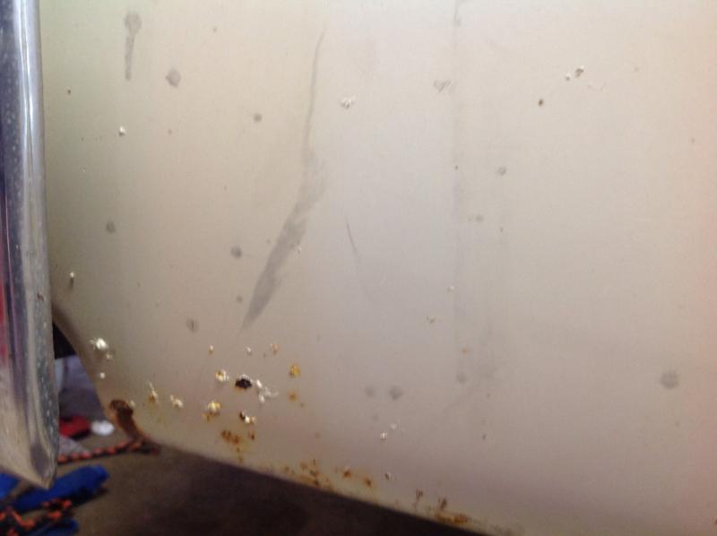

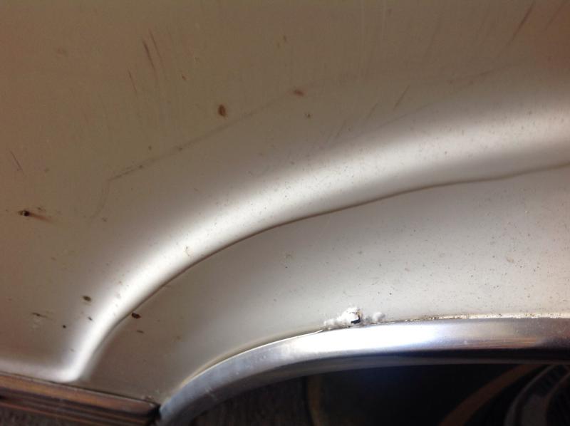

I need some honest feedback here. I've got my Ambassador for sale and sent someone about 30 pictures. He can't believe how much rust is here and doesn't know if he can deal with it. Personally, I bought the car because of how little it had. Now he wants me to sand the spots and get before and after shots.
I need some feedback please.
That is a little on the heavy side. If he wants you to do that, I would look for another buyer. If he can't see what needs to be done, he isn't very experienced.

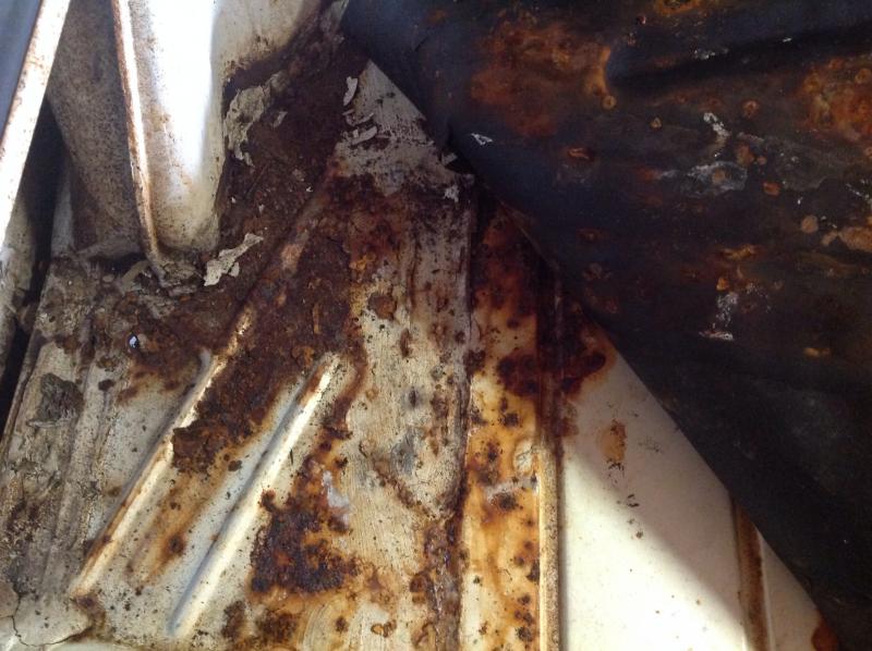

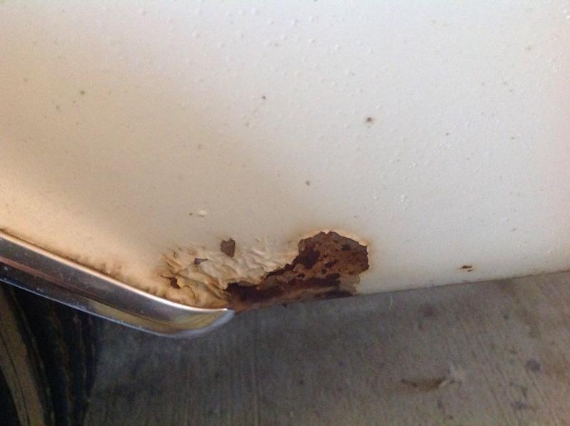

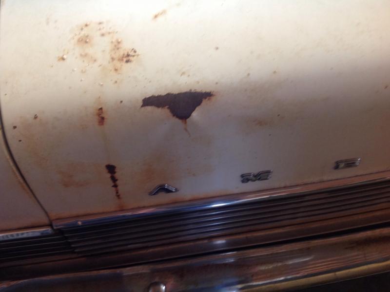

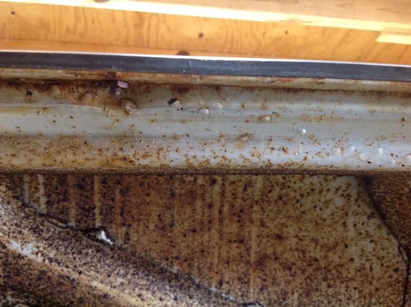

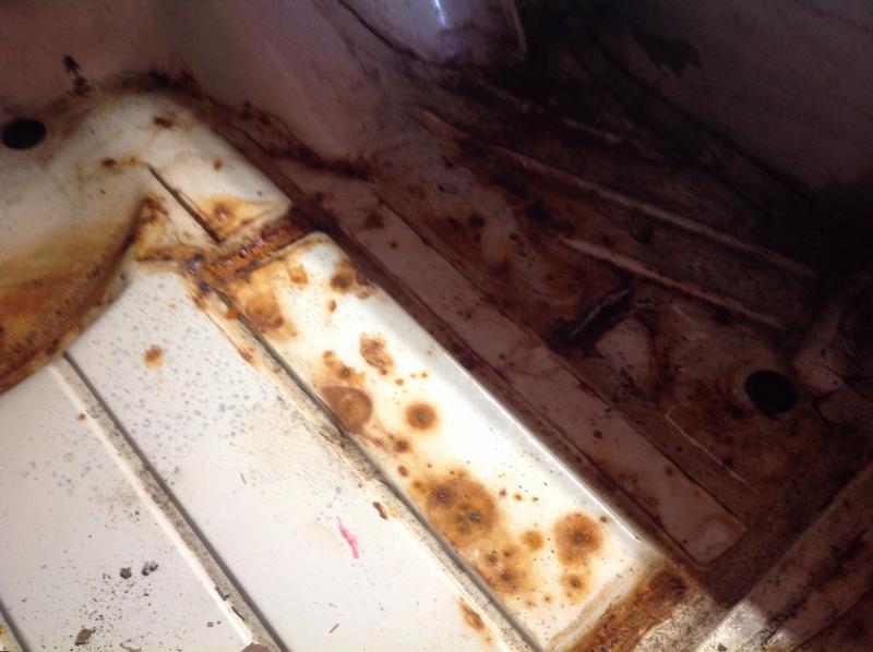

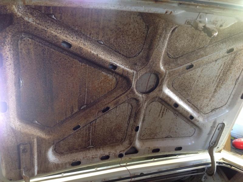

Here is the last of it. There is surface rust, but that's it.

I wouldn't grind on my car to show more rust to some potential buyer that might back out on the deal. You can tell by looking that there are rust issues that need repair. If he's serious, he needs to look at the car as is, in person, and then make up his mind. IMO if he won't do that, I'd look for another buyer.

The reality is one must understand rust when buying a car because there are different levels of it. The small bubbles visible in the paint are actually five to ten times worse than they appear. The heavy surface rust inside the trunk is mostly a non issue but labor intensive. The obvious holes in the quarter panels tell the story and will be worse than they appear. Everything you show in the pictures is repairable without patch panels if the person doing the repair is good with metal. I fixed worse holes in my 69 RR without patch panels. If I were the buyer I would look that car over very carefully because it seems to have come from a damp climate. Under body rust in between the spot welded seams may present some issues. If there is no flaking rust or expanded metal in or around the seams then probably good. And you might ask where can he find a better one?
I agree on the rust bubbles and the work required for the trunk Meep, but I never claimed for the car to have no rust or be perfect. My claim to fame for this one is it's almost untouched. It struck me as odd that he first thought it was a lot. Sure there are cars with less, but this one is in good shape. And second, that he wants me to sand it down for pics.
There is a lot of rust issues and some in your second to last picture show it most but he needs to understand what all is involved, if he doesn't want a project, then this isint the car. Most of us know whats going on but it doesn't look like he does, i don't know and im not asking but whatever the price is, if he knows cars at all should tell him, you cant wash it and head out for a party, i hope im not stepping my bounds but this is what it comes down to.
