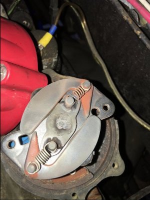

I do and I have been trying to get it all dialed in! I used a piston stop to find TDC yesterday marked my balancer and installed a tape on the damper, I have an MSD so I use the ol sears craftsman chrome inductive light and today I looked at my little timing set up for the first time and it said I'm like 50* initial and like 71* total which is not possible at all! I have an MSD distributor with the blue bushing for 21* mechanical and the light silver and blue spring to bring it all in by 2500per. I was flabbergasted by the timing thing and just don't understand why it's so off. Btw the car is running the absolute best it has in a long time! New coil, plugs and wires all MSD and sounds great no stammer or hesitation just a little ping sometimes but that is it

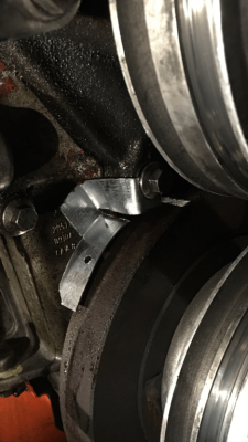

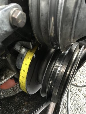

View attachment 410161 View attachment 410162 View attachment 410163
You did use half the stop distances for 0 on the tape?
Yeah I went up to just before TDC with the stop and used the hole on the metal as the mark spot, then around the other direction until I hit again and the split the difference, made the mark in between and used that as zero on the tape. I just don't get it
The little metal bit is what I fabricated for viewing on the opposite side of my timing chain cover because my real markings are hidden behind my water pump and I figured if I marked for TDC on the other side using the hole on the piece it would all jive as long as I was marking it at TDC. Am I incorrect?
