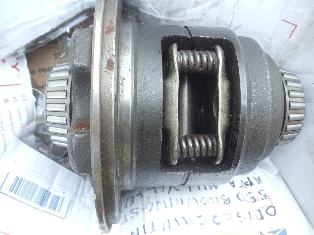

Have a used suregrip to install this week in the 8 1/4 rear end of my '72 Satellite Sebring Plus project car (318 auto-for now). According to me spinning the driveshaft and rear wheel, I figure the ring and pinion are either 2.71 or 2.76.
The shop owner of the gear shop I found stuck a screwdriver in the window of the suregrip unit to check for wear, and his opinion is that the unit is still tight and serviceable. Just hope I find no surprises, like a 2.45 ring and pinion, for example, which would have a different carrier and mess things all up.

Update: The used sure-grip was installed with new bearings and new axle bearings midway thru my 4,600 mile road trip. The installer said he uses Ford brand limited-slip additive because it buys it by the case. He said the unit made a little noise during the first part of his test drive, but it got quiet soon aftetward. I have not noticed any noise or any difference in handling.
