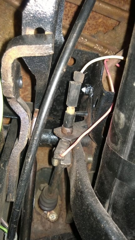

All 66-70 b-bodies power brake boosters use the linkage from the booster to the pedal, disc or drums.
It appears you are correct, sir.
I took a pic under my dash today:
That thar is a straight link from pedal swivel to the back of the master cylinder. Reckon I'll be needing all that knuckle-joint stuff if I'm going to convert this beast to power.
Oh well....
