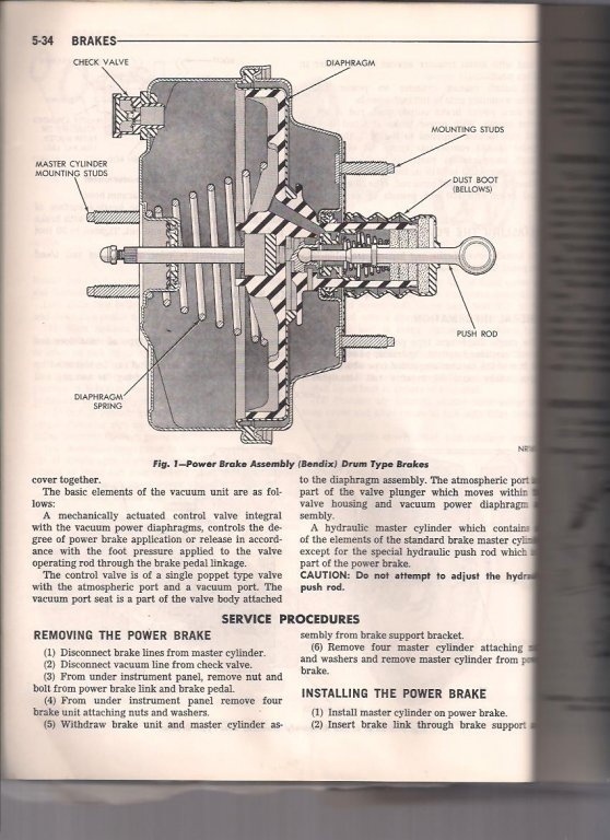

FSM has this pic of the booster:
It appears to me that the connection to the brake pedal is pretty much the same as for the manual brakes? I'd pull the pushrod out of the master I have now, mount the master up to the booster (after adjusting the booster pushrod for zero play) and bolt it down?

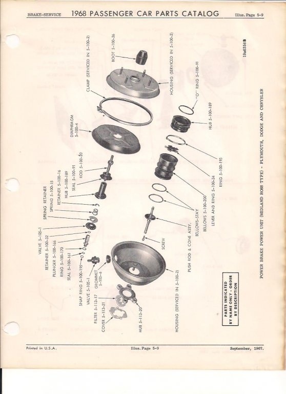

FPM open....
Drum brake booster.

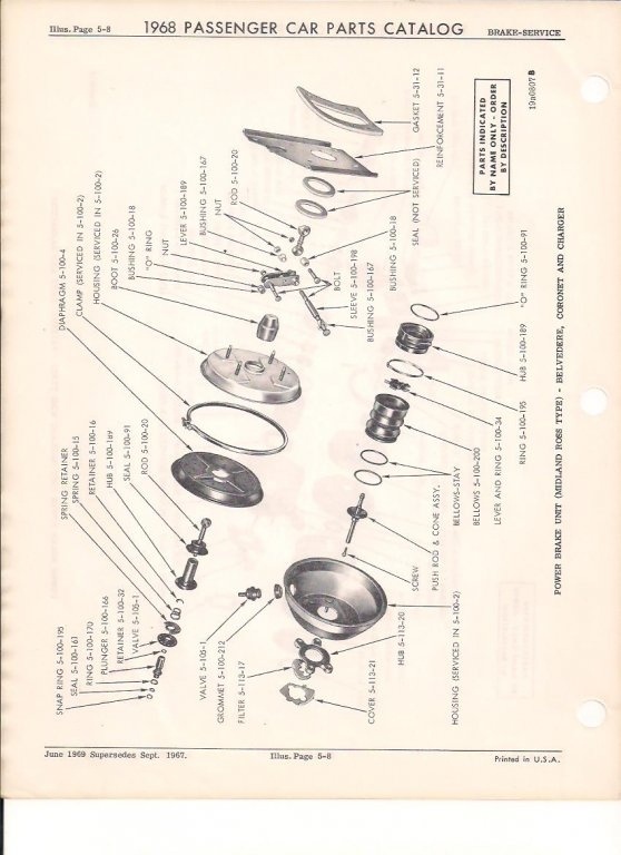

Y'all know there was a factory retrofit kit they sent to dealers to install on manual drum cars, right? Dealers literally bolted these onto manual drum cars using existing master cylinders.
Disc brake booster. It has that knuckle joint linkage to the pedal.
Disc brake booster. It has that knuckle joint linkage to the pedal.[/QUOTE]
All 66-70 b-bodies power brake boosters use the linkage from the booster to the pedal, disc or drums.
