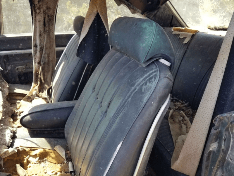

those look like GM SEATS

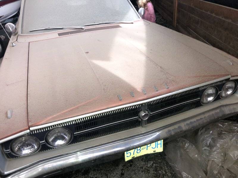

They chiseled off the inner door appliques
Made me go back and look again. Have to agree with you. The headrests look like what used to be on my Chevelle.

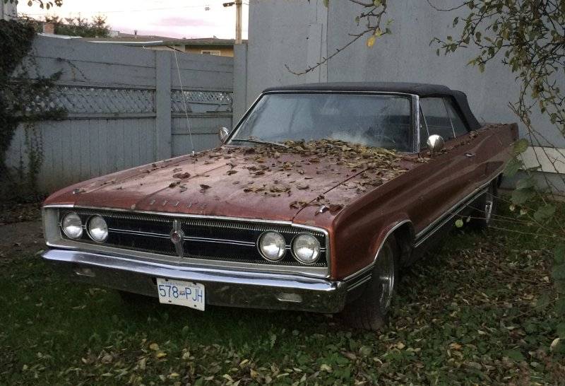

my 68 GTX has fender mount blinkers, pretty sure it was an option..... but not for a 67 R/T?
Yes it’s true. 67 gtx could have them but not 67 R/T.
Just what they did. Like no rally dash in 68-69 roadrunner, but standard on a 1970. no 70 GTX or sport satellite convertible.

Those are definitely NOT 67 seats, headrests or buddy seat.
