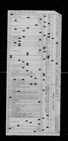

IBM Card received today from Historical Services
1 to 80
Punch Hole Numbers/Letters
Combined Codes
Combined Code Decoded
1 2 R 12 2 Scheduled Shipping Month: February Scheduled Shipping Date: February 21, 1967 Shipping Order Number: 22108146
2 2 22 2 Scheduled Shipping Day: 2
3 1 31 1 Scheduled Shipping Day: 1
4 0 40 0 Sequence Number: 08146
5 8 58 8
6 1 61 1
7 4 74 4
8 6 86 6
9 1 91 1 Region: 16
10 6 106 6
11 9 119 9 Dealer Code: 92872
12 2 122 2
13 8 138 8
14 7 147 7
15 2 152 2
16 7 0 167 X Carline: X = Dodge
17 7 X 177 P Prem. Class: P = Premium
18 2 182 2 Body Type: 2 Door Sports Hardtop
19 9 199 9
20 1 X 201 J Engine Type: J = 426 2-4 bbl 8 cylinder 425hp
21 7 217 7 Year: 7 = 1967
22 2 222 2 Plant: 2 = Hamtramck, MI
23 1 231 1 Sequence Number: 193488
24 9 249 9
25 3 253 3
26 4 264 4 VIN: XP29J72193488
27 8 278 8
28 8 288 8
29 9 0 299 Z Body Paint: Gold Metallic
30 9 0 309 Z Roof Paint: Gold Metallic
31 1 1 311 1 Paint Style: Mono Tone Paint
32 2 0 322 S Trim Grade: Sport
33 6 336 6 Seat Type and Material: Bucket, Vinyl
34 5 R 345 E Trim Color: Black and Gold
35 4 354 Basic Radio Group
36
37 7 377 7 426 2-4 bbl 8 cylinder 425hp
38 3 383 3
39 3 393 3 4-Speed Manual Floor Shift
40 6 8 406 408 Axle Ratio 3.55:1, Axle Sure Grip
41
42
43 4 434 4 7.75 x 14 Blue Streak Tires X 5
44 8 448 8
45
46
47 9 479 Front Disc Brakes
48 3 5 483 485 Front & Rear Bumper Guard Group, Center Arm Rest
49
50
51
52 1 521 Tinted Glass - All Windows
53
54
55
56
57 9 1 579 571 Undercoating & Hood Pad, Full Horn Ring Steering Wheel
58
59
60
61 8 618 Horizontal Stripe Delete
62
63
64
65
66
67
68 9 689 Special Header and Tag Instructions
69
70
71 1 711 1 Control Number: 198875
72 9 729 9
73 8 738 8
74 8 748 8
75 7 757 7
76 5 765 5
77 0 770 0 Shipped Date: March 08, 1967
78 3 783 3
79 0 790 0
80 8 808 8
Thank you!! You are the man of the hour.
Wow! What a cool car! All the right stuff!

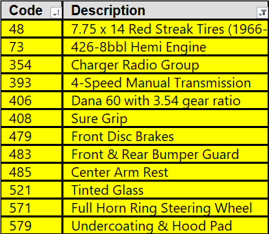

Thank you, I purchased it two years ago and have been working on refurbishing/restoring the car without making it too nice, I like the originality of the car. I spent all of the first year just cleaning, degreasing the engine bay, re-wired the car, rebuilt the front end, have removed the interior and have had the Legendary seat covers installed and new seat belts ready to go back into the car. The engine was rebuilt and I have installed into the car. I am currently replacing the dash bezel and lenses. I do have to paint the hood, roof and trunk. Then I can put all the trim back on the car. I just picked up my rechromed bumpers, after a 7 month wait. Still much to do but it is a weekend project so it take a lot of weekends and waiting for parts to arrive but definetly worth it. According to Galen, for 1967 Chrysler made 117 Charger Hemi's and only
58 Charger Hemi's with a 4 speed. My car is 1 of 3 painted Gold ZZ-1 color and according to Galen, it appears to be the only one with Gold interior, 4 speed and buddy seat interior. The other 2 Hemi Gold cars had black interior. Pretty cool stuff.
@Dean Prevolos So every time you walk into the garage, do you laugh, because you have one and they don't!? Max is 1 of 7 exactly alike. Could be the only one left. Engine/trans and paint/interior combinations and things like non-tint glass and no seat belt option. He has seat belts now though. I've had him for 36 years and I am thinking it might be time to pass him onto a new caretaker.
