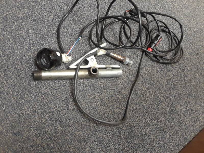

I just did the rod and spring dance with my edlebrock 1405. I borrowed a O2 clip on fabricated by a mechanical engineer I work with.
I leaned mine out from 12.8 to 13.3 to 13.9 to 14.1 depending on cruise mph.
WOT is 12.4.
Much smoother at cruise now, mpg came up from 13.3 to 14.0, and the throttle response is amazing.
Clip on O2 set up.
You clip that in your tailpipe and it actually gets hot enough to react properly ?? I could see on an open header.
You do have to get it hot. Takes about 10 minutes of driving to settle down.
