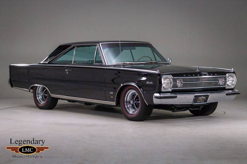

It's a 66 Satellite originally dark blue with vinyl top but now all black. Car is 4 speed without PS/PB. Appears to have had a few options like radio/clock added at some point. Supposedly came out of a small (10 +/-) Mopar collection and bought by Legendary a year and half ago or so. Block is a fall 66 casting so 67 vintage. Has fender tag but no other docs provided with car. I haven't gotten around to pulling the rear seat yet to look for a broadcast sheet. Car seems very straight and solid but not show car. Probably painted a few years ago and partly restored but sort of slapped together towards the end and been sitting for some time either in somebody's shop or at Legendary.
If this description sounds familiar to anyone who might know of the car I would be interested in any leads to prior owner. It's a Lynchburg MI car.
https://www.amazon.com/photos/all/g...c1-4e1c-b3b7-4b44cf3da6d8&pf_rd_i=13234696011
They have had that car for quite some time. I know for sure at least a year . I saw it advertised when I started looking. But the 4 spd killed it for me
I didnt know it was a color change car. Im sure that factored into a delayed sale .
car looked absolutely killer in photos
Congrats
These photos have me thinking I want to put red line radials on mine this spring .
I think from the registration they had it from late 2018. I had been following it for awhile as had a few other people. Can’t say the color change isn’t an issue but I’m a sucker for a black car so I was OK with it.
