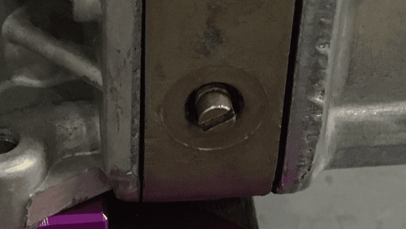

There is a cork gasket down inside this recess. It’s far enough in where you can’t even see it in this pic

The old style cast Holley metering blocks actually have little “splines” inside the recess to prevent the gasket from turning.
Perhaps with the new billet metering blocks, the cork gasket doesn’t provide enough grip to keep the screws from turning.
I’d confirm with QFT which style of gasket is “correct” for your carb before ordering anything.
I checked the QF website but it doesnt list what style is used with that carb so I'll be giving them a call.
I pulled a screw out and they are the nylon version which may be due to the metering block being billet? I couldnt stay on hold any longer with QF but at least I have my answer. The seal came out with the screw so it was not well seated in the block.
