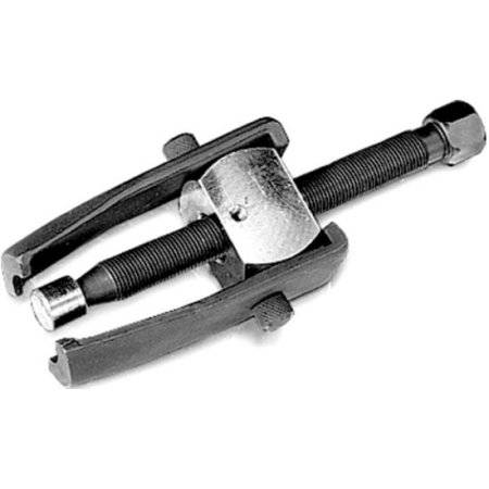

Puller, the kind where you turn the bolt with a wrench?

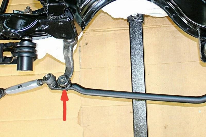

My favorite on non-show cars is a BIG sledge hammer....like a 2 lb. one & smack the side of the center link at the idler arm connection and the shock wave will cause it to pop out. I've been VERY successful with this

BFH on 1 side, smack it on the other with the next biggest you have

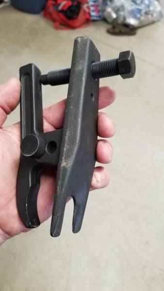

So you push up on the stud/bolt?
Yes, hook the two fingers on the center link and tighten up on the bolt, which presses the idler arm up and out of the center link.

Darn it. I can' get it off even with a puller. I guess I'll "try" to separate the tie rods and pull the pitman arm off the steering shaft and get it on a press. No way this is coming off lol.

Yes thats exactly where I'm hitting it. But I can only get so much swing into it since there are headers in the way. I'l try again later once I've figured another method of attack.
Like KK says, hit the center link; thought you were talking idler arm though. Same principle.

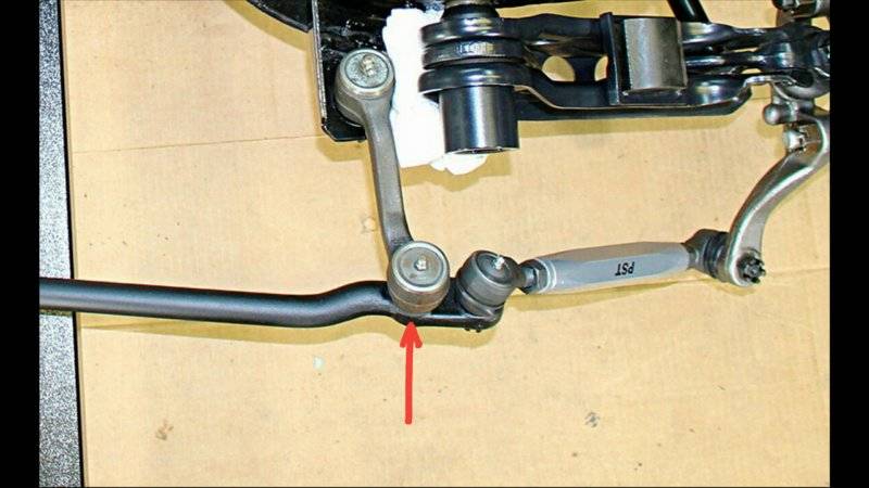

Idler Arm yes the picture above is a Pitman. I'm hitting in the same region but on the idler side.
Fn headers! Just try to turn it to the best spot to get a decent swing at it. Back up the opposite side with another good hammer. Leave the nut on just a couple of threads so when it comes off you don't get beaned.

Ya got help? A little down pressure on centerlink will help immensely.
