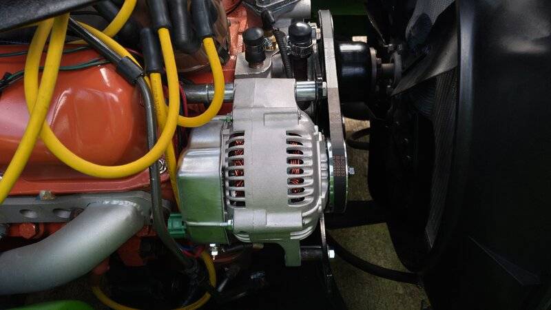

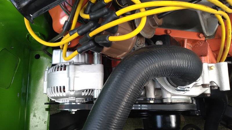

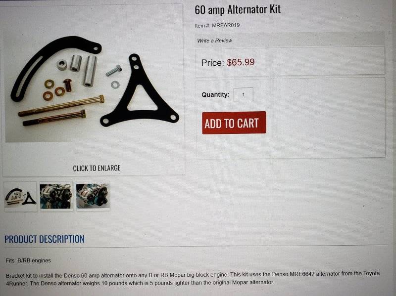

Get a 60A Denso and the bracket kit from Mancini. No more charging problems at idle. Internal regulator too!

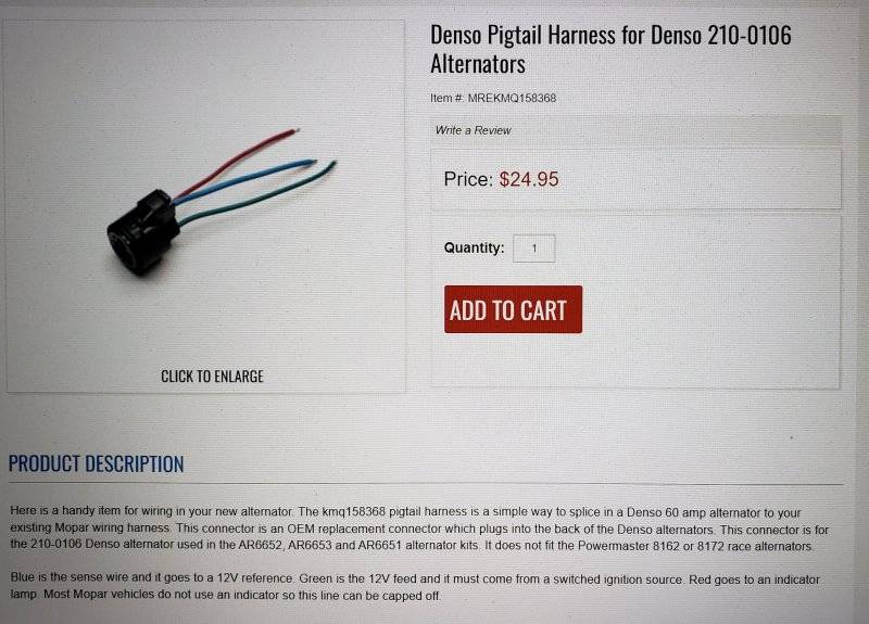

Get a solid state voltage regulator and a replacement plug for it.
You just need to run one wire from the plug to the alternator for a dual field setup.
