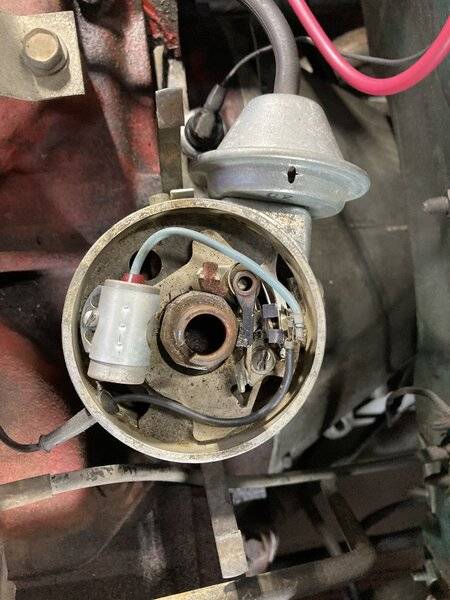

I own a 65 Dodge Coronet 440 4dr w/318 Poly V8:
I am looking to upgrade the ignition. I have looked at several companies and eventually purchased a Pertronix unit with the Ignitor III (Part # 71318A) and their Coil to match this Ignitor unit
I attempted to install it and it just doesn't seem to fit correctly. Actually I think it might be the wrong part. Its doesn't easily fit inside the distributor and the directions are horrible.
Any suggestions or thoughts on what type of electronic ignition I should order? The attached photo is from when I removed the distributor cap. I am not 100% sure if its the original cap and rotor.

Could be because you have the old cast iron distributor instead of the newer aluminum style?

I am not sure. I bought the car about 2 months ago. I am slowly upgrading and fixing things and thought to upgrade the ignition. So I am not sure what distributor I currently have... The pic is all I have.

IMO....I concur whole heartily, poihts will be just fine for an occaisional use vehicle. Looking at pix of the distributor, it appears to be using Blue Streak points and condenser. The distributor looks to be a little corroded and rusty. There should be a metal tag on the distributor body, usually inder a cap mounting screw or points mounting plate.....it would be helpful to know the info on the tag for future reference.
