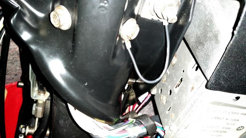

idrivemopar or anyone else for that matter, if you have a picture of the ground wire on the steering column to dash frame on your ride I could reference I would GREATLY appreciate it! I lowered the column while doing all this and disconnected a few wires from the column to dash and cant figure out where and how they go back... One of the black wires I pulled down is broken as well (I has two circle electrical connectors on it that a bolt would fit in). I should have taken pictures, and now I see why everyone says that, but after working on it in the sun and 95 degree weather with no breeze for 7 hours the heat was getting to me and I was getting frustrated and mad and just wanted to get it done... Now I know to just call it quits and cool down and get back to it later.

Here is the column ground wire, this is on my 73 RR, but I believe is the same on 73 Charger. Mine was the same way before restore, it was broken.
I just put the column ground wire up and still get nothing from the car when i try to start it with the key. Any further ideas??
