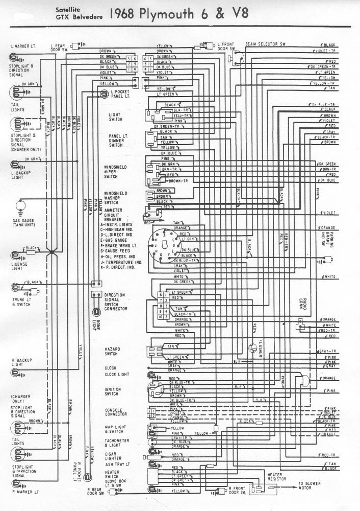

I too have a 68 GTX with fried ignition switch. I have a replacement but would like verification of which wires go to which posts (as some melting ocurred on mine). Anyone able to relay a quick diagram?
Thanks
Thanks
here ya go...it's towards the bottom; ignition switch
Thanks Mapar. I too have the diagram but my old eyes are not doing the best following it...at least would like to verfify. For example, I think there are five wires. Red goes to? Blue goes to ? White to? Etc.,, would be greatly appreciated.

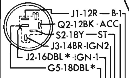

Here. This is out of the '69 manual, but I'm sure it's the same. I believe the unused terminal is a ground on some models
You'll have to turn it the right direction to match this up but most switches are marked on the rear
Top left is a large no12 red, battery coming IN
Top right unused
Middle left is dark blue, "ignition run" or "IGN 1" and also feeds the cluster
Middle right is no12 black, accessory feed off to fuse panel
Bottom right is yellow, the start wire to the start relay
Bottom left is brown, "IGN2" the coil resistor bypass circuit

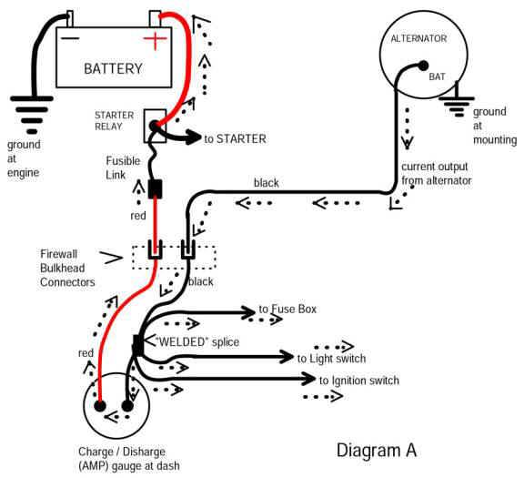

well guys, with your help from the diagrams (thanks 440raodrunner) I got my new ignition switch in and it fired right up. I back it out, shut it off and re-fired it with no problem...everything seemed great. I took it for a 10 mile cruise for lunch. Then as I went to re-start it, it cranked twice, then NOTHING. Not even headlights working?? Towed it home...not happy as you can imagine...
Today, re-checked wiring on ignition, nothing touching, etc and all wires hooked up. I also tried bypassing Alt gauge and still nothing. But when I jump at solenoid it will crank. So i"m not getting juice to the cabin. What is best way to check ignition switch? Wondering if I should try red wire to ACC and see if "juice" or not? Wonder about fusible link too?

Use this diagram from MAD electrical to help understand the major supply path. The power comes into the interior of the car through the
fuse link, and goes next to the
bulkhead connector
From there it goes through the ammeter, (red wire) and then comes out (black wire)
The MAIN supply for the interior, if the path is OK up to now, is the IN HARNESS SPLICE, sometimes called the "no1 splice" This is a factory welded splice in the ammeter black wire, taped up in the under--dash harness and supplies
the headlight power to headlight switch (but not tail, park, or dome)
the ignition switch incoming power
the fuse panel hot buss
maybe a couple of other things in some cars
SO get a test light or multimeter, and identify the fuse link which normally "looks funny" and usually has a rubber "tag" on. It comes off the starter relay big stud and goes to the firewall connector. If you have power there, move to the ammeter and see if IT has power.
If not, it's either a bad fuse link, or trouble in the bulkhead connector.
If you have power on both sides of the ammeter, turn on the headlights and see if power drops off. (Putting a load on helps show up a poor connection)
If you still have power on both sides of the ammeter, unhook the battery, do what's necessary to get into the dash harness, and untape, following the black ammeter lead. These splices don't fail very often but they can, have, and do.
Still one more check, with everything hooked up, and headlight switch on, is to see if you have power at the alternator output stud. If you do, but have no headlights, it's a bad factory splice.
