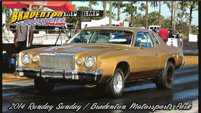

Welcome back. Congrats on the grandkid! Like any newbie, we need pictures.
I'll take some new ones when I get it out of the garage this weekend but will this one do for now?
