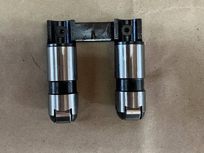

There's quite a few 1000+ hp guys at our track now, which I'm sure all have rollers and not all fail. Attention to lash, and newer tech lifters help negate the issue for sure. But after seeing guys putting cars on trailers after going to roller gave me the willy's for years. I'm into reliability and enjoyed zero issues with flat tappet race cams .. but now we will see how the roller works out.Ca
Can you share the details?
I know of one: Red Zones, 900 hp, 900 lbs and 0.90” over the nose, 350 passes.
And my point is that just about everytime the subject comes up with running a street roller on a lolly-pop street cam lobe the fear mongers come out and talk about filling your motor up with needles. You’d never guess that we used them for 40 years before the days of: “you have to use bushed rollers.”
Also, word of bushed roller failures are popping up.
Again, buy quality.

I believe having the longer hydraulic roller lifters with shorter pushrods will change the angle of the pushrods somewhat, it would still be good to recheck it before running it.Good advice. I have 3/8" pushrods in place now but I've not noticed any contact marks on them. I had the engine out in 2022 but I don't remember looking too close at the pushrods.
Yes that's true, I don't have any thing solid to bring forth for helpful info. I just mentioned my own personal fears about it. It's more of an internal fear mongering lolWithout the details of the parts used, and the conditions, it’s just not particularly helpful info. I do know of several more roller lifter failures, but they weren’t good roller lifters.

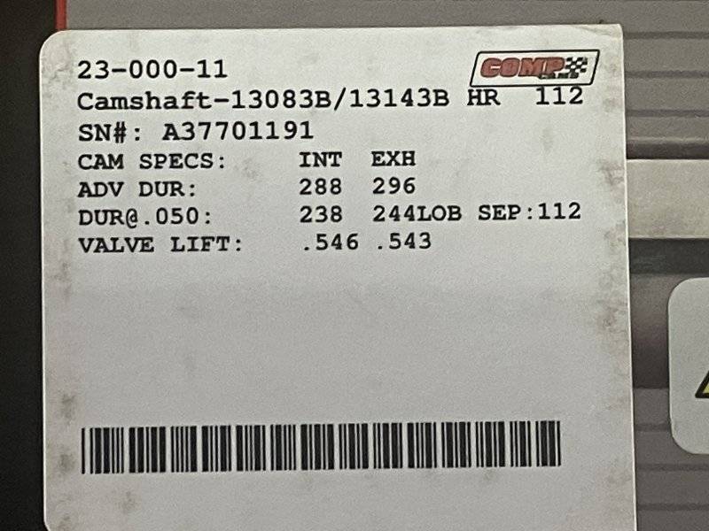

Those specs are based on a 1.5 ratio. My rockers are 1.6 so the lift will be .582 and .579.

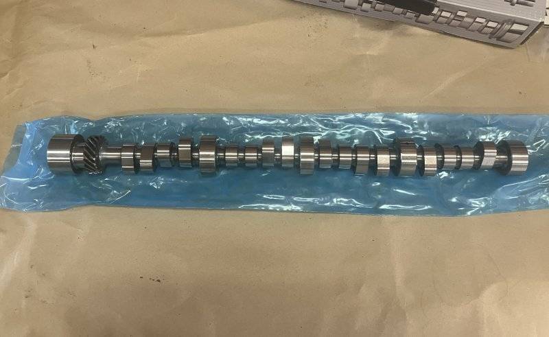

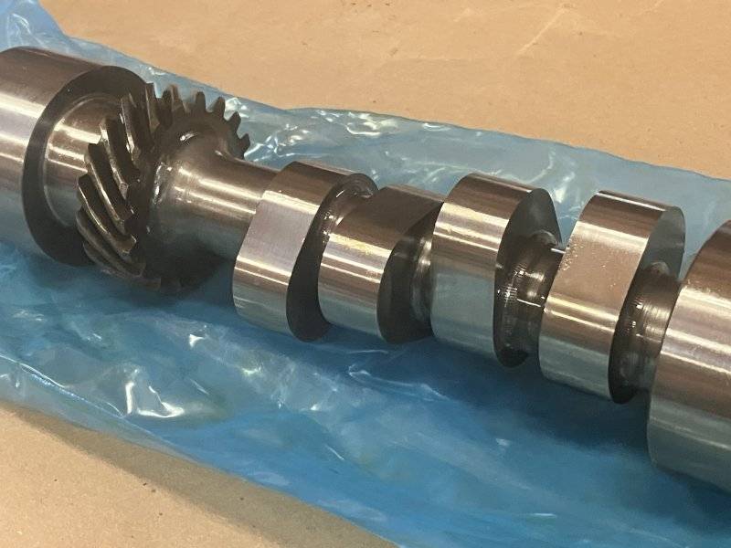

The difference in the shape of the lobes versus a flat tappet….
I’m having a hard time understanding how a lobe with so much meat in it before max lift can not be some much wilder
