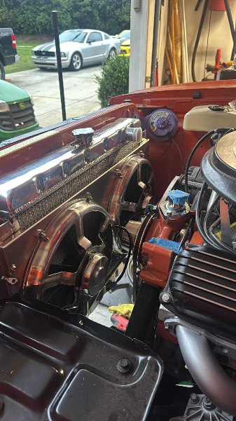

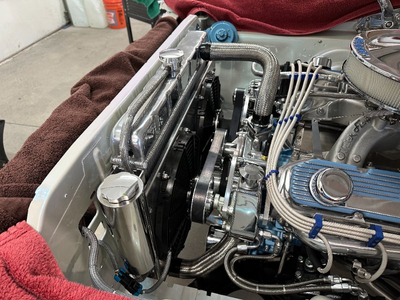

HI,
Ordered their radiator for the SB HD It would bolt up to the stock bolts .. the one that's in it now is wider and had been bolted into new holes drilled in to the core support ... so I'm going to need the stock bolts that screw into the stock mounting pieces.. does anyone know what size these are look like maybe 3/8 course.. ??
1/4" course, with large captured washers. Mega Parts has them. Or you could go basic washer and bolt from the hardware store .
HI
Got the radiator Looks great, fit was a little off Had to drill the two top holes in the core support not a big deal and use fender washers to hold the bottom .. But WOW does it cool,, gauge barely goes over 1/4 mark. with 185* stat.. going to have to up it to a 195* I think. I'll see how it goes this winter... very happy with it. with no shroud.
