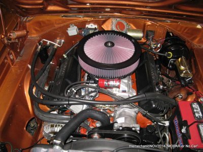

Here's a couple of engine pics with the Bouchillon pulleys and Sanden Compressor fitted to my 360;
Only a slight modification was required to the compressor fixing bracket where the bypass hose runs on top from the block to the water pump.
I'll get some more detailed pics up tonight for you RC. :icon_thumright:
The compressor has 4 fixing holes - bottom one needed shaving off to give clearance for the bypass hose;

I bought a Classic Auto Air system for my 70 Road Runner. The car is not on the road yet, so I can't tell you how well it works yet. I am working on installing the A/C as hidden as reasonable, so I used a Bouchillon low mount pulley kit. I also have pictures of the control box and controls.

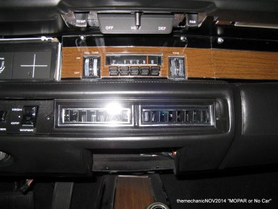

So far, I like it. The only thing I am not thrilled about are the A/C vents that sit under the dash. They are small and a bit cheesy - however I figure I could always change those out at some point if they really bug me...

Oh, and as someone already mentioned...the Vintage Air vent outlets do look a little cheesy, but they actually look fine under the dash in this little Red Terror :eusa_dance:

Seriously, it actually bolted up pretty nicely. The directions I received with the kit as far as shims did not make my belts line up perfectly, so I played with the shims myself to ensure everything was nice and straight. Of course, I haven't run the setup yet, and I worry if there will be belt slippage if I am running both A/C and lots of electrical items. If I do end up with some issues, I could maybe put a dual belt pulley on the alternator and get an A/C crank pulley too. I would have to figure out how to drive the power steering, but I won't worry about all that unless I have issues. I'll keep you posted.
With my air grabber car, I certainly did not want to have a big A/C compressor sitting on top of the engine!
