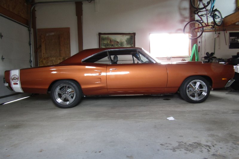

Make it higher than you want, it will settle down with some driving and will need to be evened out again.
For me, I prefer lower than stock front & rear for better handling. Watch out for front tire clearance. Set it where you like. However, as I’m learning, Mopar stock suspension doesn’t allow for a lot of caster (desirable). There are inexpensive upper control arm caster adjustment cams that can get you 2-3 degrees of caster. “Stock” caster in something like 0 degrees which makes the cars “squirrely”.
