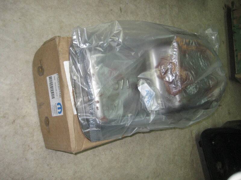

Looking for a 971 oil pan in good condition...
Anything out there?
Thanks!

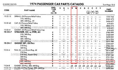

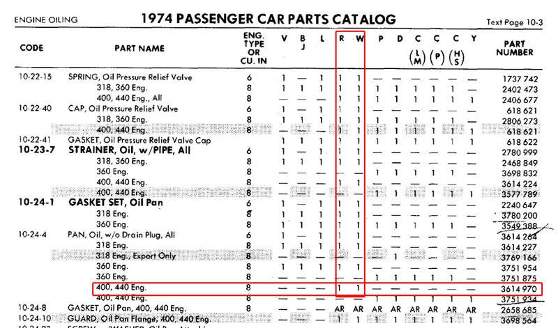

Got this info from another site.
If anyone needs a 971 pan, just order up P5007807AB.
Matching 3/8 pickup tube assy is P5007848.
Here it is on Mancini's site. https://www.manciniracing.com/38censum.html
Here is the pickup tube. https://www.manciniracing.com/mooilpiandsc.html
The brand new one sold as P5007807AB is my first choice for a pan but it is sold out everywhere
and is discontinued by mopar so we probably won't see any more of them. I've searched all over
the net for that one and come up dry. :-(
