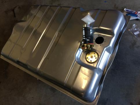

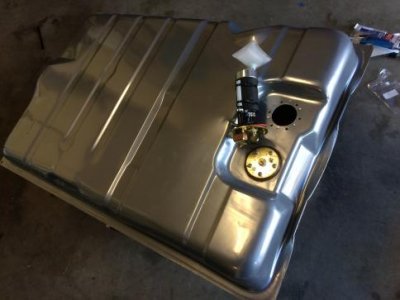

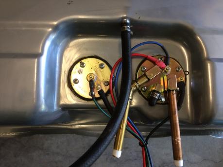

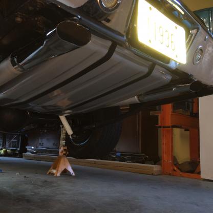

Well I hit the tanks inc tank, pump and sender for about $600 to my door. Install was straight forward. Tank is powdercoated also. image.jpgimage.jpgimage.jpg
