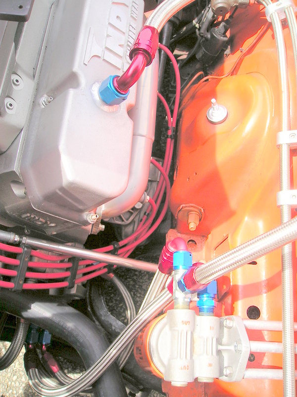

You could drill them with a step drill and weld an aluminum bung on that way you can use screw in breather , an fittings ..., gives you a few options good luck Picture 388.jpg

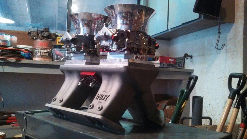

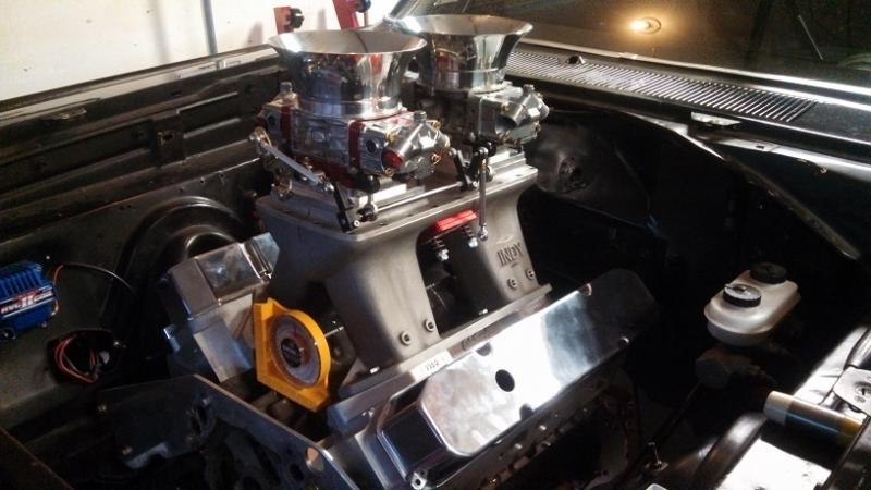

IMG_20141221_134204_222.jpgResizedImage_1405054147793.jpgThis is the low deck version, CFE burst plates, QF 1050-AN 4150's, and Enderle linkage.

Also (in my opinion) you must use a "screw in stud (just like the one in the picture the guy posted with the welded bung) and then the nuts with the serrated bottom, You can buy those studs from INdy. You can't get them long enuf at a specialty hardware store...trust me,,, i tried. Good Luck
Fastenal carries the studs in whatever length you need and the stainless serrated nuts as well.
It is not just a stud that you need...it is a stud with an "allen wrench head" to screw them into the heads. I still think you have to get them from INDY. Just a thought.

MoPower....please post some pixs of your entire engine compartment (and engine)....looks very interesting. Thanks
