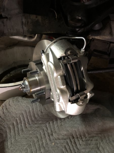

Post some pics of your front conversion. I assume the rear are still drum?
Rear are drum and everything for the conversion is new except the booster which is factory. The conversion was made to be used with the factory booster.

What hubs and rotors are those?
Or what kit is this?
Looks like stock A Body 4 piston calipers to me so I’m just trying to figure it out. Most people convert to single piston floating. Slipper design
They are mustang hubs and rotors and are a Leed brake kit.
