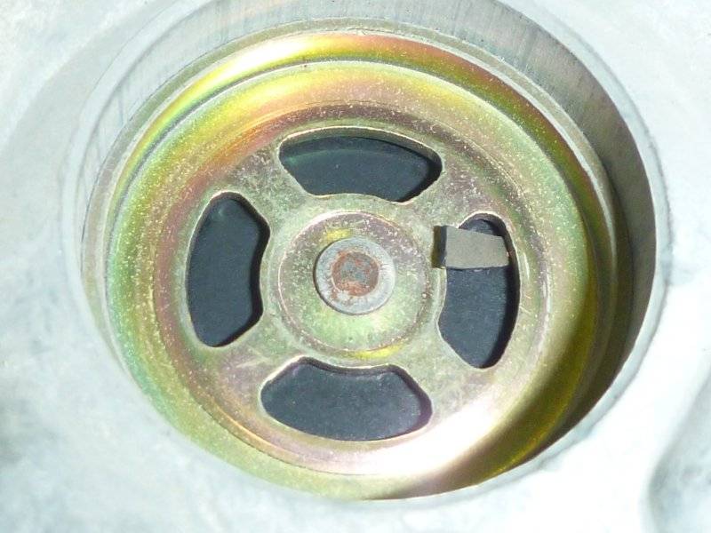

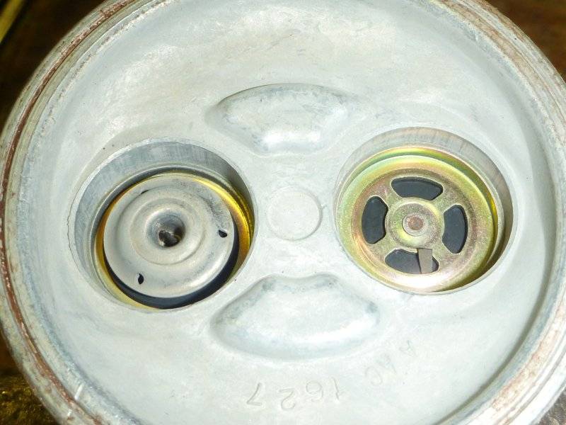

IMO......The carb inlet / floats are the check valves as well as the fuel pump discharge has a outlet check valve to prevent EXACTLY that. There is no need for additional hardware.
BOB RENTON
The only way it's draining back is if your pump checks are leaking, or you have something in one of them!
This has been discussed recently in another thread. Before installing a band-aid that may not produce any results, check things from front to back such as fuel line hose clamps, pump pressure, filter, pump pushrod if big block, etc. Like @dadsbee I can let mine sit for 1 week or 6 weeks and it will start by the first, or second try at the most. If you're running a Carter/Edelbrock 4bbl I can't see how fuel would be "drained" back to the tank once the bowls are filled.
The carb cannot drain back to the tank.
The fuel level in the carb is not high enough to sit at the needle seat to draw a siphon on the bowl. Some pumps do have tiny holes in the check valve button to allow vapors to bleed off so the fuel line could go empty to the pump bowl. But the gas in the carb bowl evaporates causing your hard start. As other have stated above and in other post.
