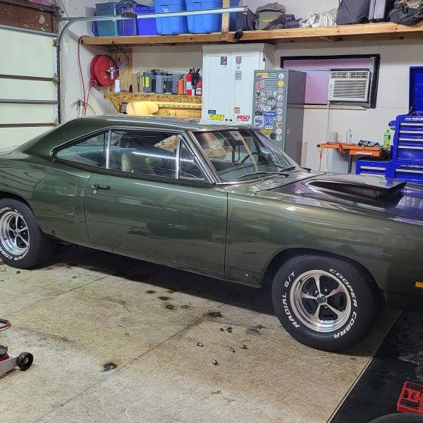

Hello everyone, First time forum user. I have a 69 super bee that belonged to my dad. I can turn a wrench but am definitely not a mechanic. I currently have an inline fuel pump that is activated by a switch under the dash. I would like to have it turn on automatically when the key is turned. I know I need to use a relay but wondering where to hook it up? I know these old mopars have some finicky electronics (learned a lot installing an MSD ignition system). I have a full wiring diagram, just need to be pointed in the right direction.

Love that color. beautiful car.

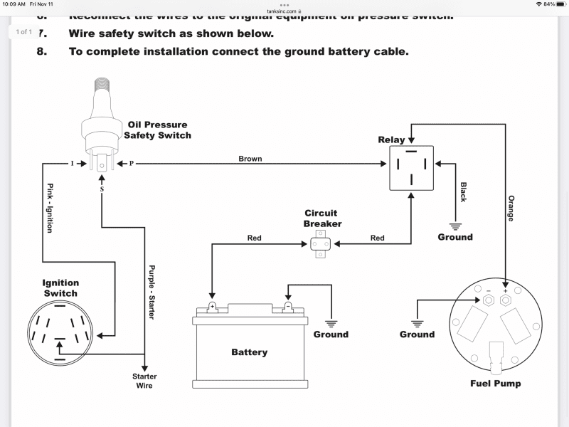

Have you looked at the part yet? Thats the beauty of this switch.. It has three contacts.. One is for the idiot light, the other two are for the pump circuit..
Amazon product ASIN B00153AZWY
Thanks, I did. This how tanks inc shows to wire the three prong sender. I don’t see how there’s a terminal for the light? Also not sure why one leg is shown as going to starter circuit? Maybe that’s yo allowed the pump to work while cranking?
wiring is not my forte so any help is appreciated…
