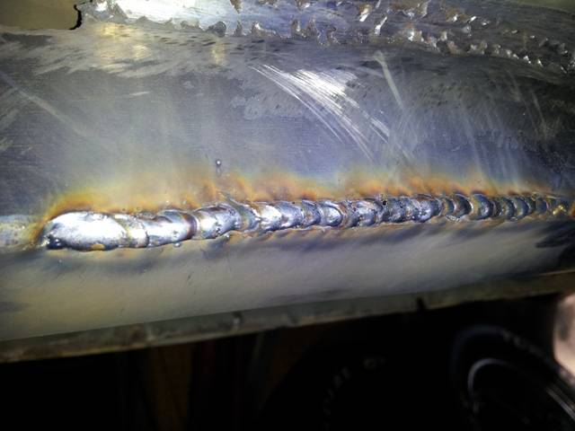

Welding up the US Cartools frame connectors . . .
Post some pics, this is interesting to see what you all are doing. Thanks.

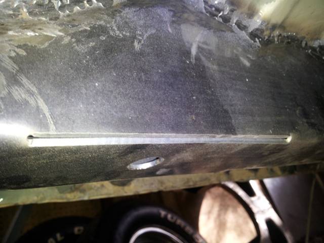

Sure Donny - we're talking about finishing up the install of the US Cartools frame connectors.
Turns out the the frame connectors from US Cartools needed one additional piece of work to complete them, and I missed it.
The connectors come with some reliefs at the bending locations, probably simplifies the bending process.
After installation, the reliefs need to be welded up - to make them continuous and probably make them that much stronger too.
So, the reliefs look like this:
So I've welded all of the reliefs on both frame connectors ( 12 of them in all )

on the slots in the frame connectors, I have yet to weld in my slots. it is a relief to allow smooth bending just as "con67" said. the upper portion (welding attachment edge) would be wavy as crap with out these. I am a little undecided about full welding, as there will be no opening for water to get out if it got inside. I have another set of the frame connectors from XV Motorsports I did not use as these really did not fit at all. I expected to do a little modification but they looked like they were for another car. I could never get them to respond to any calls or emails, so I bought the US Car tools ones.

oh guys, just saw the above pics and see the hole in them! mine do not have a hole in the bottom, soooooo, I will drill a hole or two and weld the reliefs.
just as Donny said, I made two holes in the floor pan and sprayed them thru the holes with the little painting nozzles I made, I did use epoxy primer.
