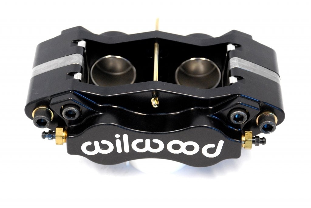

Looking for some input on front brakes, I currently have manual drums all the way around so almost anything is going to be an upgrade. Whats the best bang for the buck as far as braking power? Manual 11" 4 piston Willwoods/SSBC or a single piston power setup? Street/strip 67 Coronet that is driven a lot, thanks.
For starters - Welcome!
Best bang for the buck? The 4 piston calipers, modern ones, give more clamping pressure across more of the pad. Single piston will give you very good braking for normal everyday driving. If you your going to put the car through its paces then the Wilwoods would be my vote.
I have 4 piston Wilwoods on both my 66 Dodge and on my 62 Dodge Dart. The 66 Dodge weighs in at 3950 with me in it and full of gas and stops just fine at 130 mph (no power brakes). The 62 Dart weighs 3850 and also stops great with no power assist.

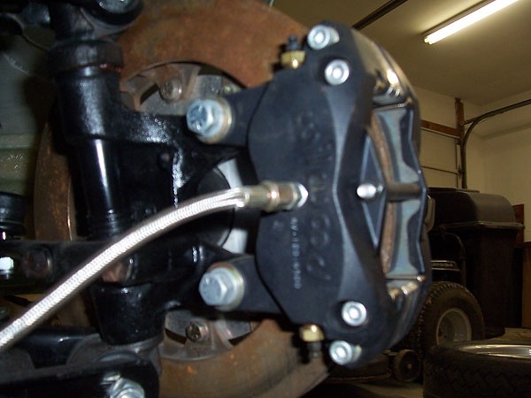

Did your SSBCs tell you to pull the caliper , flip upsidedown and bleed the bottom bleeder?
Just curious, weve vacuum bled, pressure bled and pedal still felt spongy. We purchased a Wilwood MC havent installed yet but the guy at Jegs said he had to do this on his SSBCs...???
Hemi,
The bleeder is on top.If yours are on the bottom switch sides,,,,,
Thanks! But they are on each side (4 total,1 for each piston) top bottom , inboard and outboard.
Thought the SSBC's were the same
