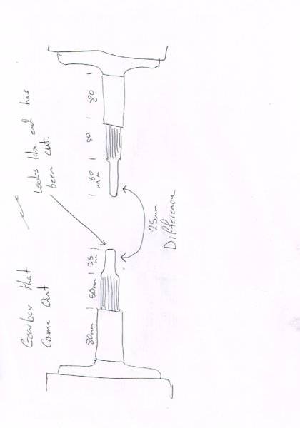

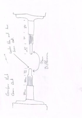

Took old 4 speed out and tried for hours to get replacement one in, was always 25mm ( 1") gap between housing and 4 speed casing. Finally took it out and used a ruler only to find the input shaft was 25mm longer on replacement one. Looks like the gearbox that came out has had its shaft shortened.
What are my options please.

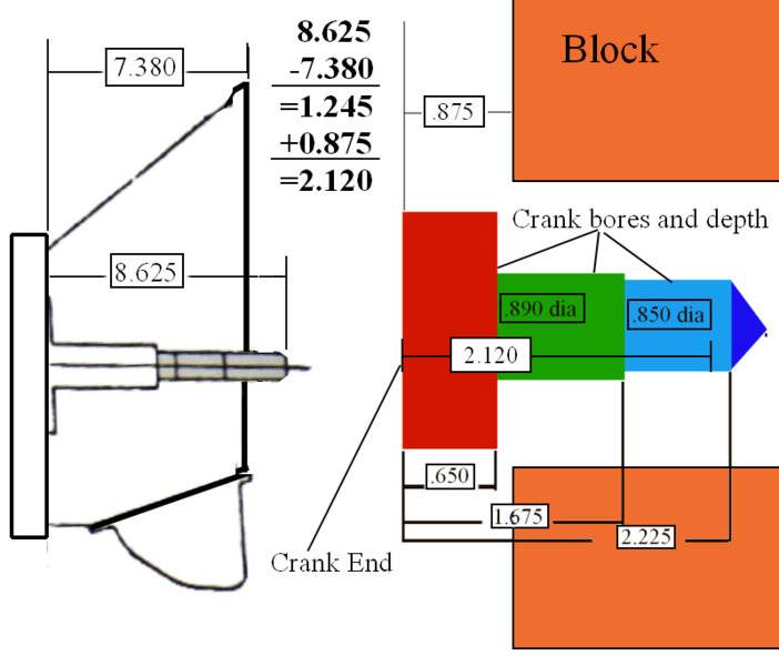

It seems your crankshaft is not drilled for a pilot bushing. If there is a pilot bearing in the torque converter pilot area of the crankshaft, then you are good to go, but you will have to trim back the trans input shaft same as the old one. Just make sure there is a pilot bearing in there.
It’s not the block, it’s the crank, some are drilled for the 4 speed, some are not.
Just ran into the same problem on my 65 Coronet...replaced the 727 auto with a 4-speed. Crankshaft was not drilled for a standard trans...use the big pilot bearing in the converter area at the end of the driveshaft, cut and tapered the input shaft...and i was out crusin with the four speed....
Good luck......
Good luck......
Had the same issue, cut and tapered and had no issues!
