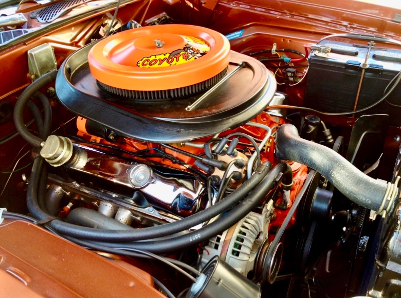

Mini starter makes this tons easier than the heavy oem unit. Mine came out of the bottom of my ‘71, meaning the front end of the car needed to be a bit high. Over this winter I’m going back to my oem manifolds.
It is a mini starter.
Still a PIA
And yes the driver side only goes in from below.
Just curious. How come you are going back to the stock manifolds?
First of all I still have the originals, plus my Hooker Super Comps are looking a little ratty, even though they’ve been Jet Hot Coated. Considering selling my car so looking to make it as original appearing as possible. Plus I want to replace my solid motor mounts with something a bit more “livable”.
