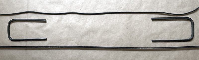

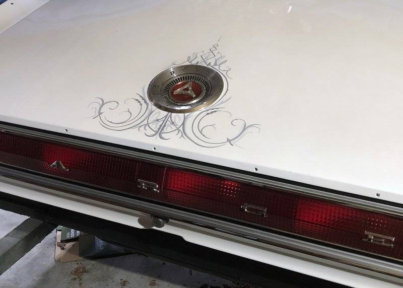

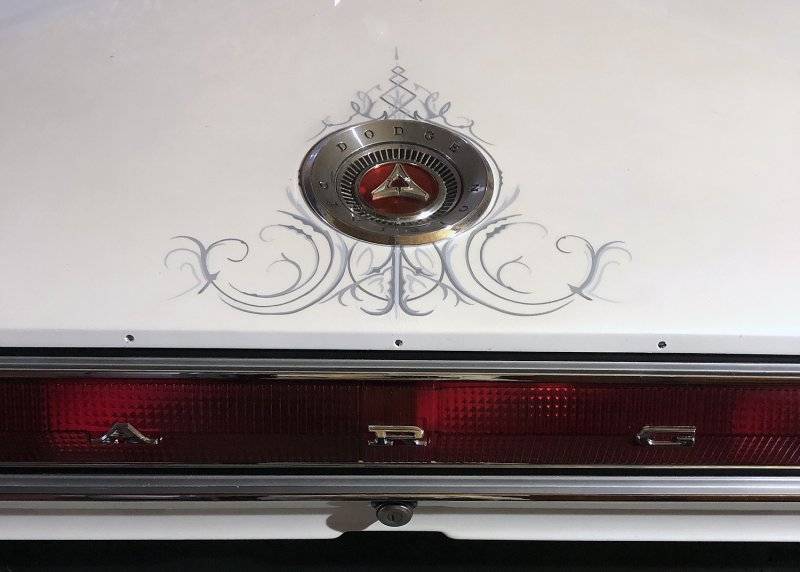

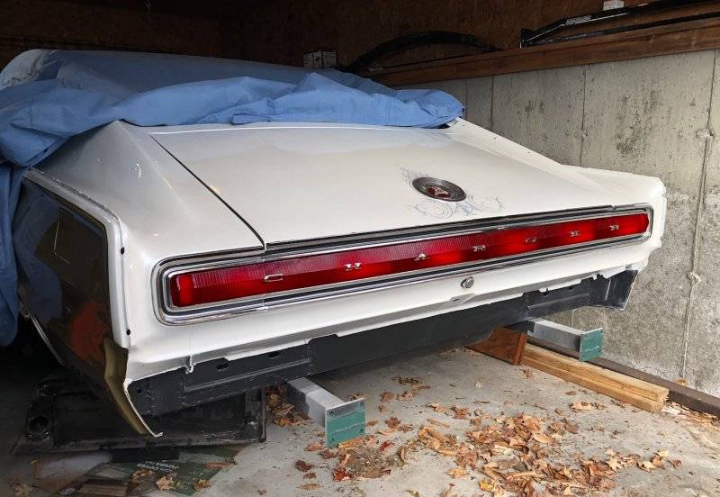

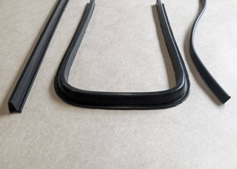

I installed the tail light assembly on the Charger today utilizing a "Full Set" of OEM style gaskets that I made myself
dance
Still have to attach the last piece to the deck lid though... maybe later today, or tomorrow.
Oh yeah, I installed the trunk lock first
think
Nice work ! :thumbsup:

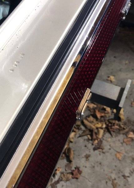

What did you use for the upper long piece? I'm thinking the 64 polara guys could use it too..
The gasket for the long upper piece of the assembly is an appropriately sized U-channel rubber. The trim piece for the deck lid never had a gasket from the factory, but I will be adding one. I'm thinking about using a strip of 3M Automotive Trim Tape there.
Added the piece to the deck lid the other day utilizing a strip of the 3M Auto Molding Trim Tape

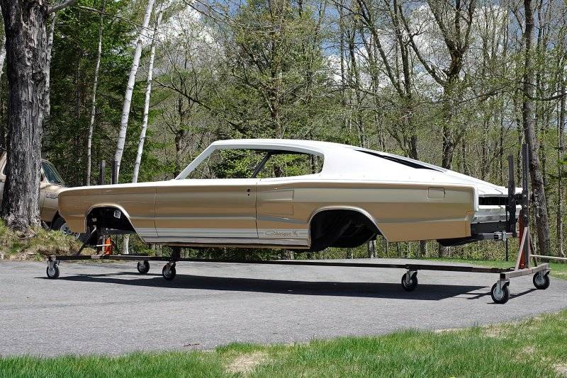

Do you have a side pic of the whole car?

For those of you considering getting these gaskets from 67 Mopar (Mike), do it!
I picked up the upper and lower gaskets. Not only does he do a nice job on previously unavailable pieces, but he goes out of his way with help/information. He originally spent the money and made the molds so that he would have these for his car. He's generously making them available to us...take advantage while they're available. Mike's a great guy, support him.
Sorry for the extreme delay! This is the only side shot I have at the moment.
The colors (White & Gold) each look different under various lighting conditions.

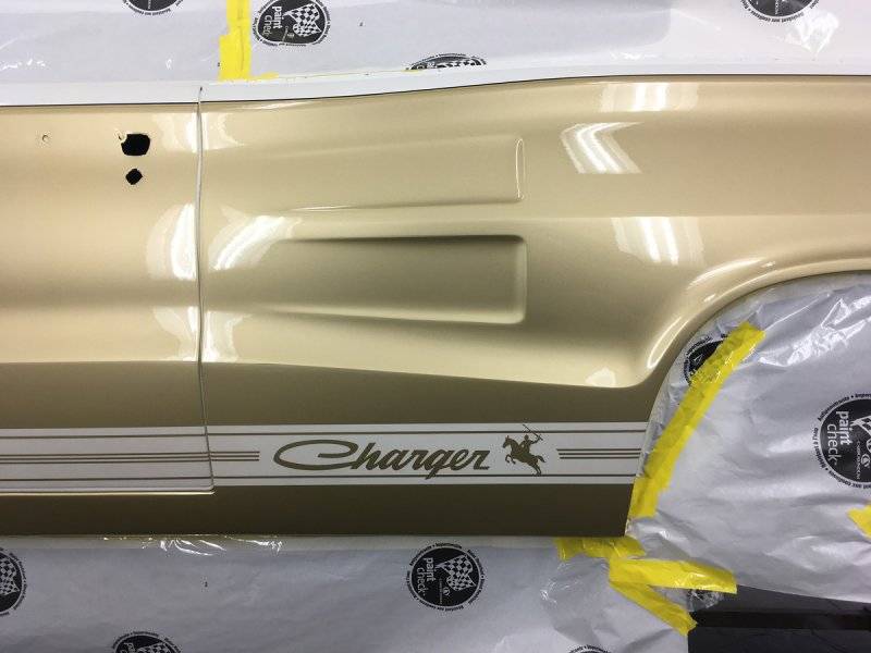

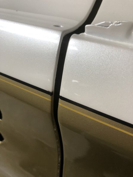

I drew the design for the Rocker Stripe by hand and had a template made for painting it on the chassis. The pin striping is all done by hand as well. Lots of small details inside & out.
dance
think

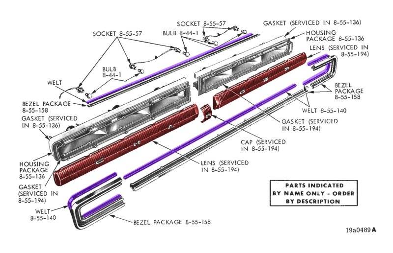

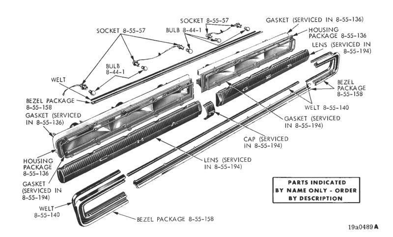

So how are the chrome bezels attached? Are they glued on or do the Light lenses hold them down. I'm going to replace mine and I want to know what I'm getting into.
The chrome trim pieces are screwed to the rear housing, sandwiching the lens between the housing and the trim. There are a number of gaskets involved obviously... a foam gasket at the back of the housing, another higher density foam gasket on the front of the housing where the lens sit, and of course the 4 gaskets that sit between the body and the chrome trim pieces themselves. It all gets put together out of place then attached to the car as one big fully assembled unit.
The housing gaskets are available, but the gaskets for the actual Chrome Trim surround pieces are not available with the exception of the outer "C" trims which "sometimes" come with gaskets if purchased as a kit. I made molds for all four of the trim gaskets however, so if you find yourself in need of one, two, or all four, just give me a shout on the PM system, or shoot me an email at [email protected]
