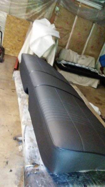

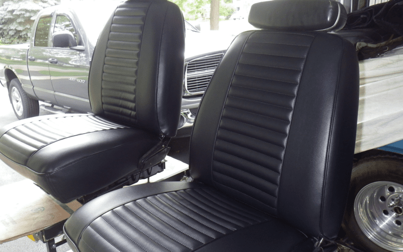

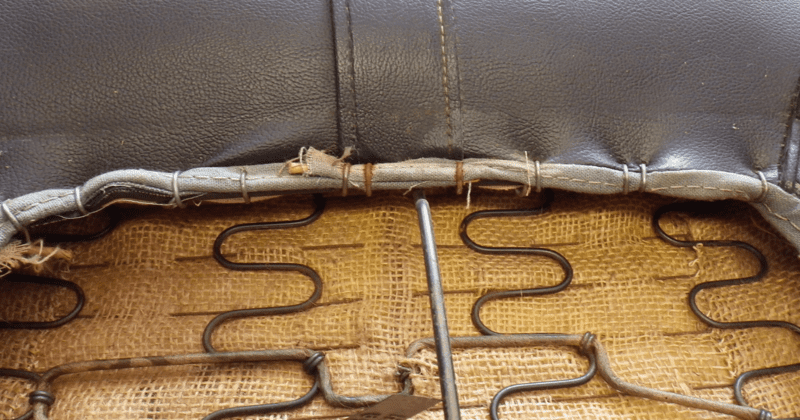

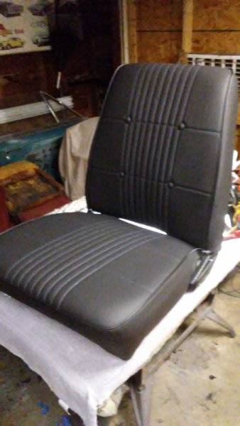

I purchased my foam from legendary, and my covers from another company. Watched the youtube vids, and went at it. I covered the seat back foam with plastic kitchen size trash bags, and the covers slid on easy. I also taped plastic over the front edge of the seat bottoms. I ended up buying 3 different pairs of hog ring pliers and several sizes of hog rings. To help with the seat springs from wearing through the layer of burlap, and to help distribute weight, i first hog ring secured a piece of carpet to the springs. The front seats are much easier than the back. Though they both turned out fine. If your stitching lines on thr top & bottom don't line up, its just a matter of taking some hog rings out, and reringing them.

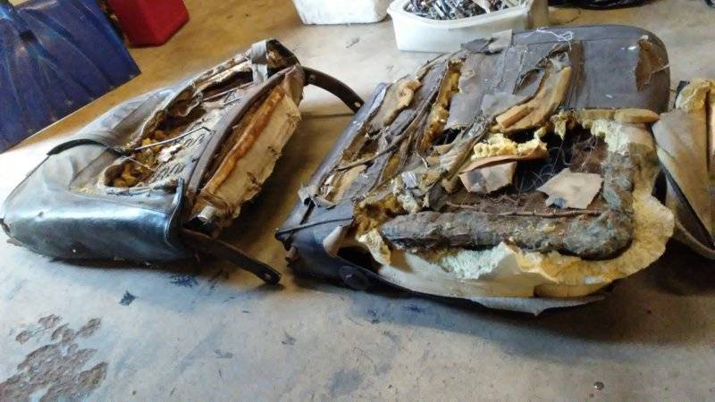

I carefully removed everything, taking many pictures as I went. Make sure it is clear what angle, side, etc when taking pics.
Original foam was formed, not a big squared off piece, there was metal wire in places, they give you the cardboard stuff for everything. Also, my backseat had cotton at the base of the back between the springs and the burlap.
