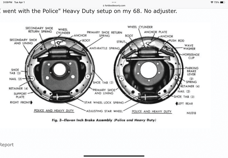

Putting new shoes on a 67 GTX that I put shoes on 20+ years ago. Wanting to make sure I have the adjusters mounted correctly and didn’t screw it up 20 years ago.
I believe the adjusters on the front end have the star adjuster towards the rear as this photo I found on the Internet shows and per my existing set up.
But, I notice that the rear example in this photo shows the star adjuster towards the front on the left rear brake. I haven’t pulled my rear drums yet. Is that correct? Both sides?

All 67 11" drums are heavy duty/police. No difference. If I'm not mistaken the adjusters are marked L&R. The wheel should line up with the backing plate hole for adjustment.
Hi Jerry. I tried cleaning mine up but couldn’t find any markings. They are a little rusty on the surface but work fine. I did adjust my front drums a few months ago and the method of adjustment went correctly. Pretty sure when I put new linings on years ago, I did one wheel at a time and kept the hardware with the particular wheel. I’m less certain about the rear but guess I’ll figure it out for sure when I get there. Just seems odd the star adjuster would be towards the rear on the front wheels, but towards the front on the rear wheels per that picture. All my backing plates have 2 adjustment slots so they are no help.

The "L" and "R" are stamped on the end of the star wheel. Take off the "cap" and look at the end.
Mike
From what I can figure out, the manual adjusters all have the same thread. The star wheels are toward the rear on the right side, and to the front on the left side. This is so the adjustment tool moves in the same direction for tightening, on all wheels.
OK, I didn’t look there for the marks. But I wonder why they are marked L and R if the threads are all the same? I may have to switch it around on my left front if that is the case. Either I or a PO might have switched it around years ago on the left. I’ll spin the star and see if they are threaded the same.

Auto adjusters are marked right and left. My parts books listed one part number for manual adjusters and two for auto adjust, R and L.

Got the front brakes done and new bearings installed. The adjuster star to the rear on the Rt side and to the front on the Lt side does work. Turning the star down on both sides correctly spreads the linings out.
I think when I installed shoes way back I could only find info on self adjusting brakes in the Plymouth shop manual and the star wheel is always to the back on all wheels, thus the different right and left adjusters. Different approaches.

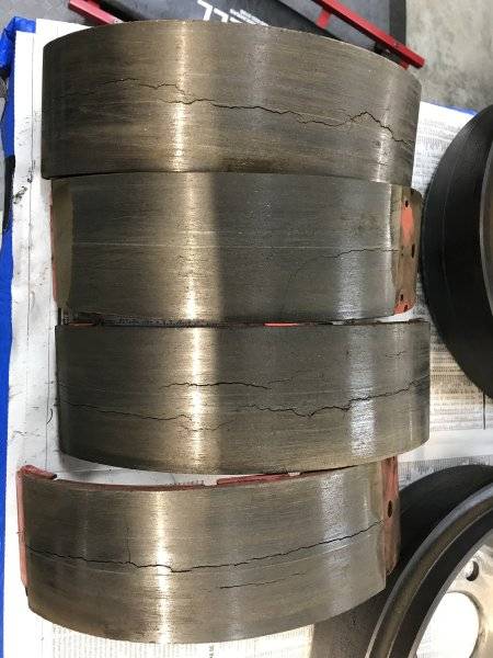

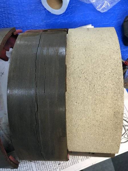

Forgot to post. Here’s what you brake shoes look like when the hoses go bad and don’t release pressure. Burnt and rock hard.
NOSR asbestos linings from Craig Stanley with Mobileparts.
