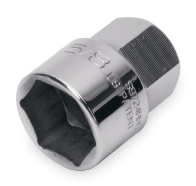

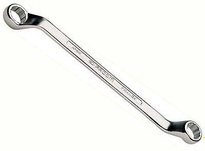

I'm guessing #2 plug, for stock heads I think you can get a combination wrench on the plug to get it out, for aftermarket heads with the recessed 5/8" Hex, Snap-On makes a nice short plug socket that will slip over the plug and then you can get a wrench on it.

Thanks I think I have sockets like this, will try tomorrow
Most spark plug sockets have a hex head you can put a wrench on, that's what I do anyways.

I used a 3/8ths drive socket on my 440 Challenger.....but I think I still used an open end to turn it. Dang...30 years passed by in hurry!

I have the 440 Source heads on my 440, and the #2 plug is so close to the shock tower than I could not get a normal spark plug socket on it, and the spark plug hex is recessed in the head so you can't get a wrench on it. That is why I mentioned the socket above.
