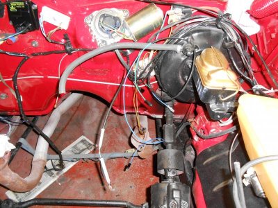

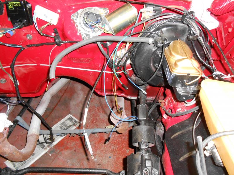

Well, I don't know how much help I can be BUT I am in the process right now installing the speed control unit and cables.
On my 73, the hole is almost directly under the power brake booster to the left (driver) side of the steering column and next to it is the brake release cable.
Pictured below, the old cable is painted red but you get an idea of where it is.

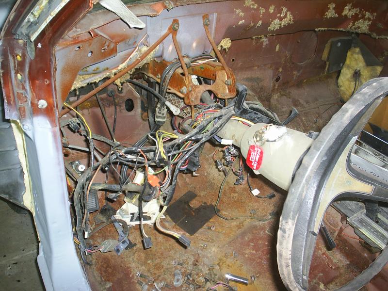

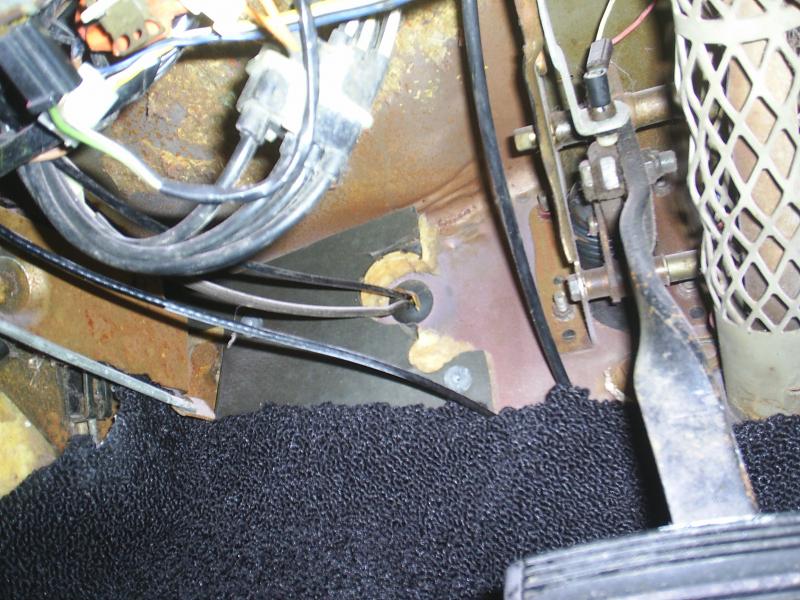

And in this picture Just left of the brake pedal but under the carpet. The one below that you can clearly see it.
